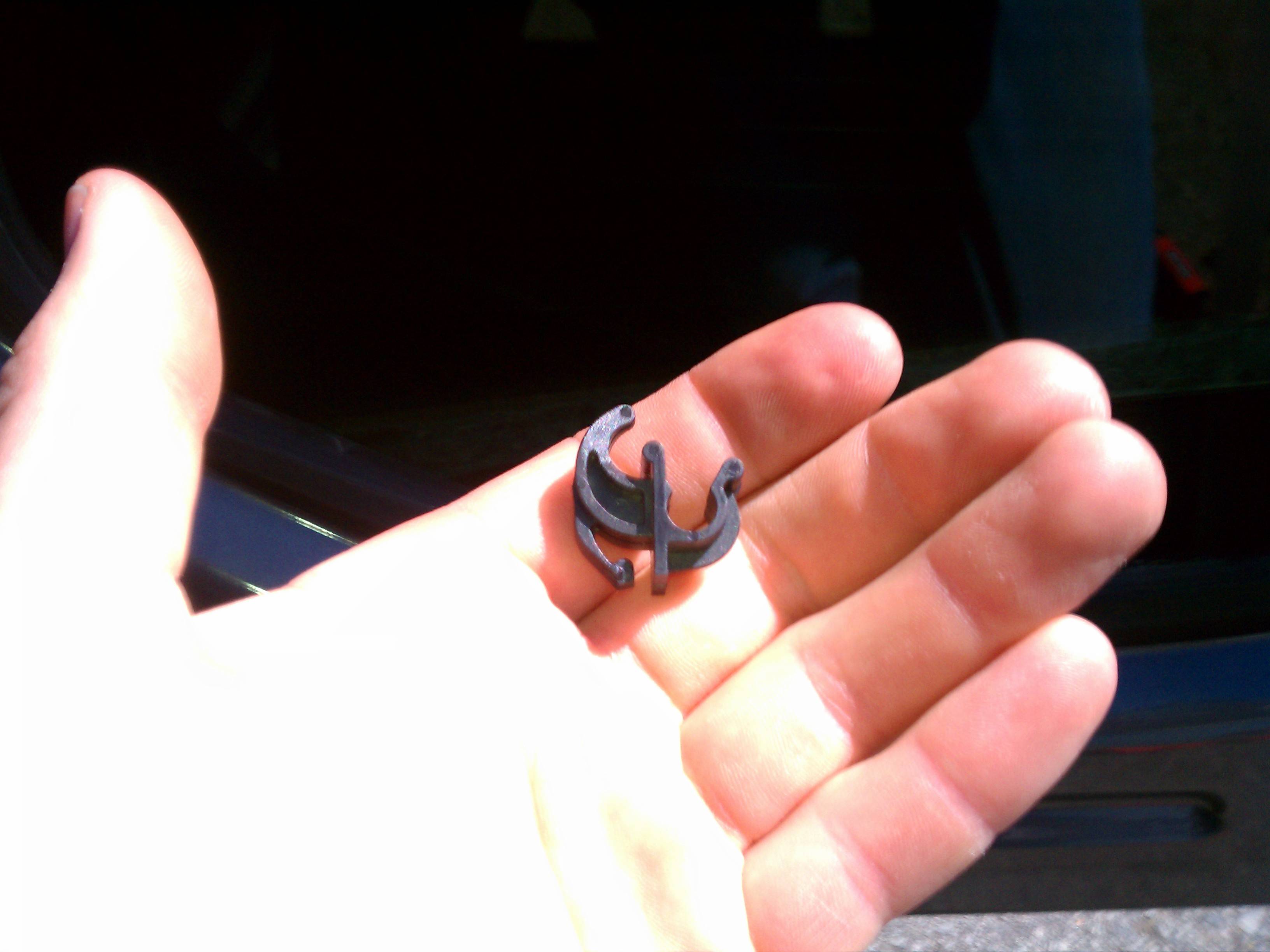

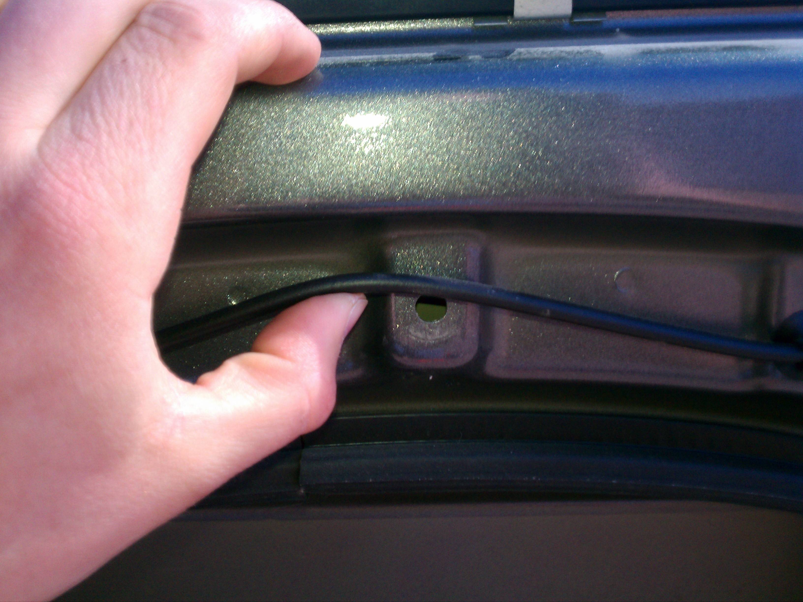

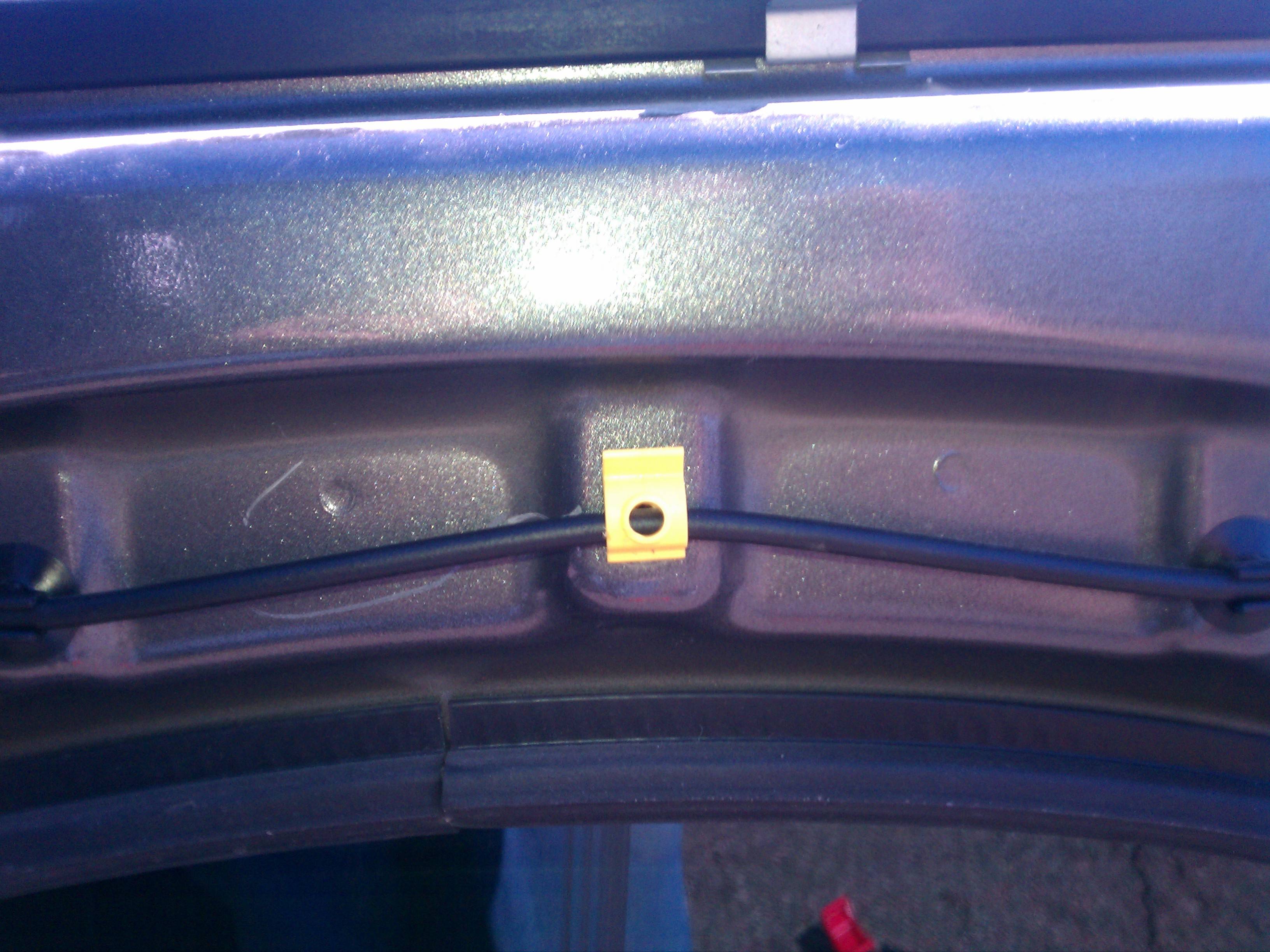

Three bolts on Y, one under reflector, pop panel off. Three clips that hold the cable in place, right in front of you. Is one missing or broken? Replace it with something.
