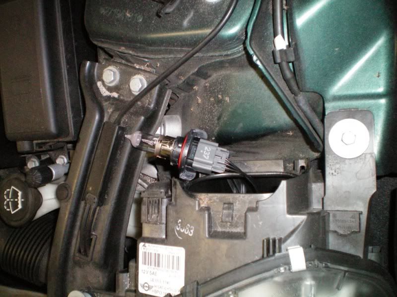

well I just pulled one of mine (07-S hard top) in about 30 seconds - took longer to open the bonnet, I can never find the darn latch.
Here's looking at the driver side, the headlight unit is pointing down
pop off the door and find the bulb connector, about 1/4 turn "anti-clockwise" and the bulb and connector is free, pull it back. You can now release the connector clip from the back to free the bulb.
Perhaps I made it easier by not reading the directions first! Remember to not touch the glass of the new bulb, the oil from your hands will burn on the bulb and cause early failure.

just twst and the bulb can be removed, the connector just snaps on the back of the bulk
easy
