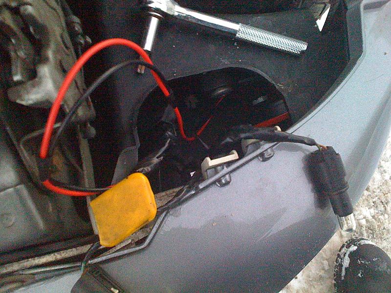

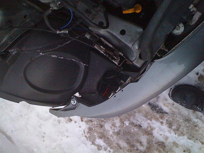

So I was able to disconnect the turn and daytime running light, and horn connector, pull both lights out of their sockets and moving everything to the side. This was the passenger side.
Got the bolt out and with flexing the plastic around the hole a little, spinning it around, etc and the bumper flexing got the old horn out without damaging it, not that I care about that dead horn!

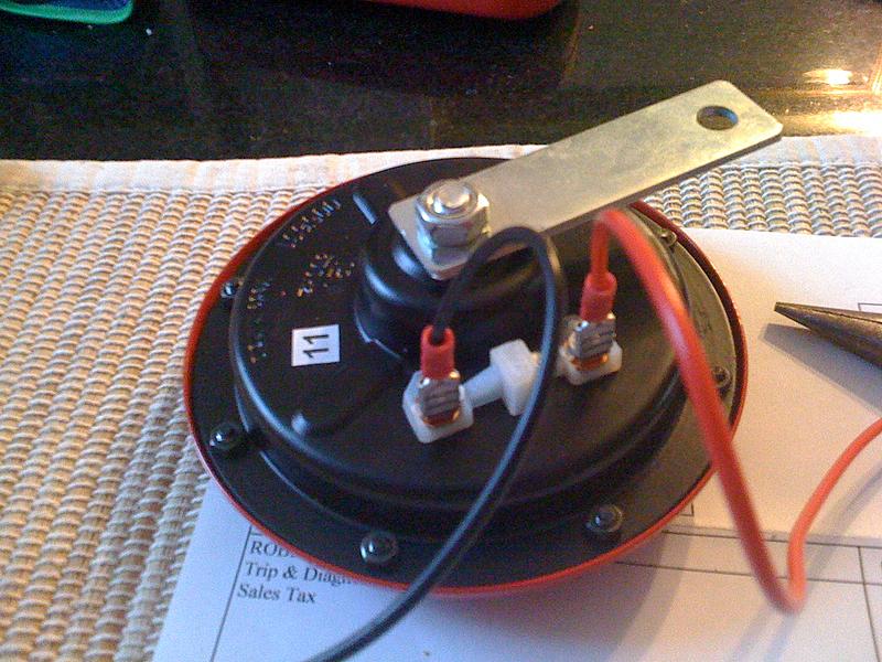

So I made up the harness for the new horns, just some blade connectors on there and added about 8 inches of wire. Clipped the old connector off, striped the positive lead, then started on the negative lead and about 3 inches of wire just came out. Great job on making your ground wire splicing MINI! No biggie, I can just ground somewhere else.
So I connected the harness to the horn and tried to get it in the hole. Doesn't fit, much bigger than the old horn. So angeling it so one corner in the front / center of the car and the back / passenger corner, I was able to just barely flex the holes plastic and squeeze it in and then have it fall into the bumper. Good thing I have the wire harness attached to it so I can pull it back up.
The bracket fit perfectly and I only had to bend the blade connectors on the horn towards the bracket so the back would clear (Done before I pushed it in anyways, had to bend a little more. Bolts on perfectly. Had a temporary connection of ground to the grounding strap for the engine and it worked great!

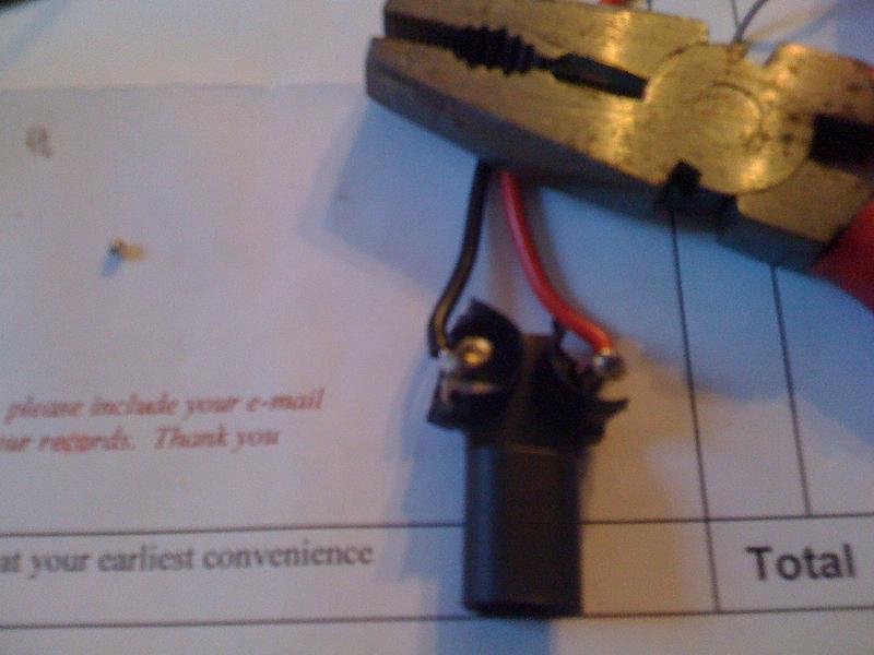

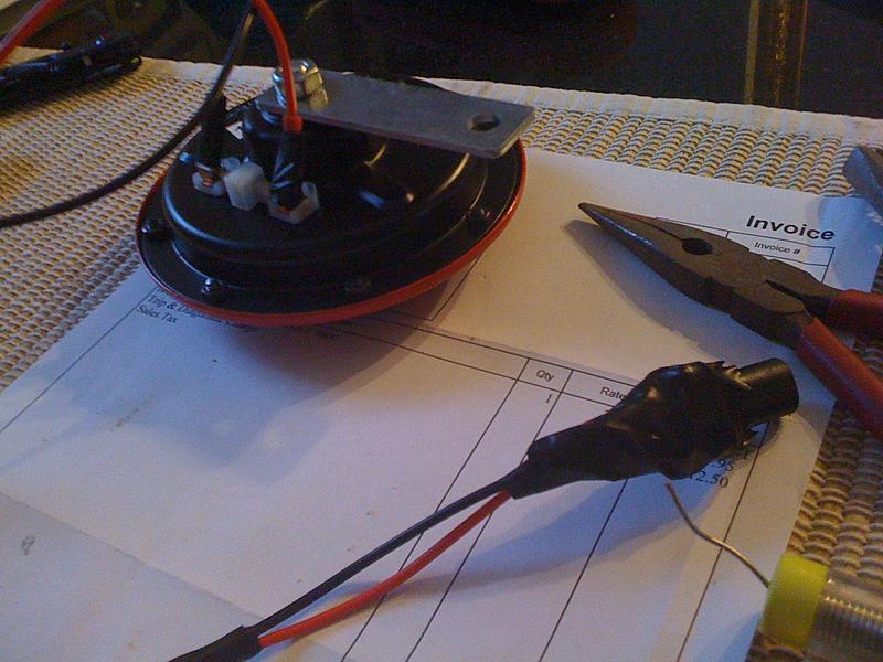

Started the second horn tonight, before cutting of the pigtail, I noticed on the old horn the connector is removable! So you have the horn, connector, then the pigtale. So I pulled that off, butchered it, connected wires, electrical tape the crap out of it and tada! I have a factory connector for the 2nd new horn to the existing pigtail.

Pics for anyone interested, I soldered the second horn to the old horn connector/bridge and just taped it.

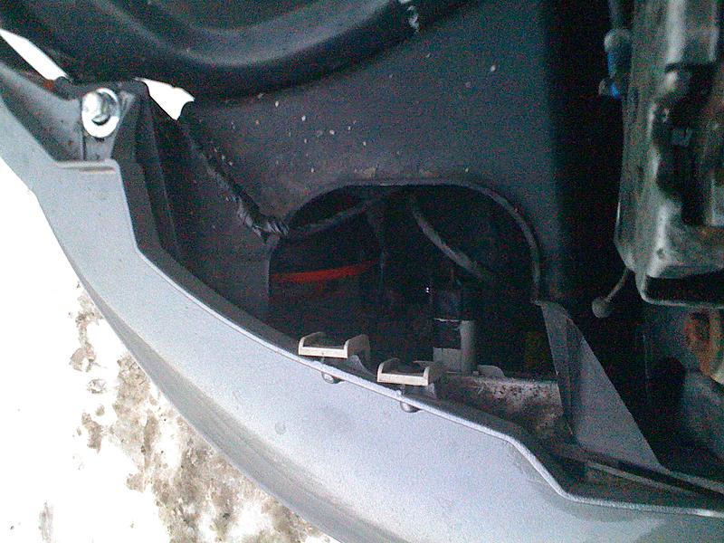

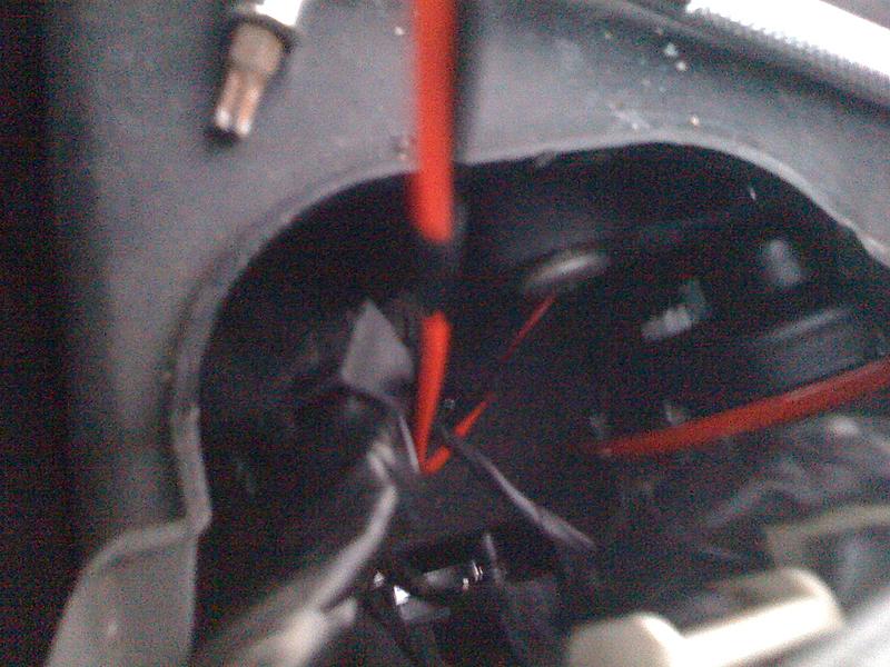

Installed in drivers side before tucking in wires and replacing lights, and last one is passenger installed.
