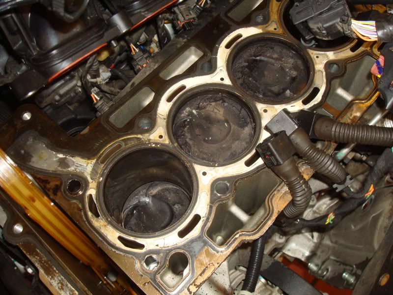

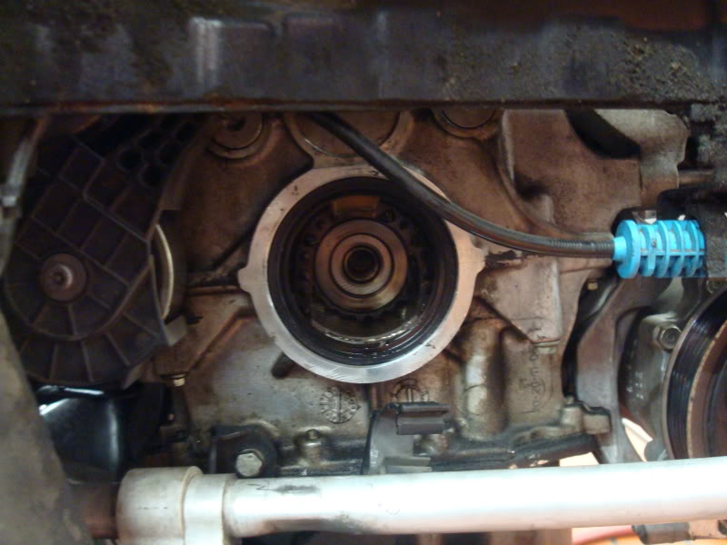

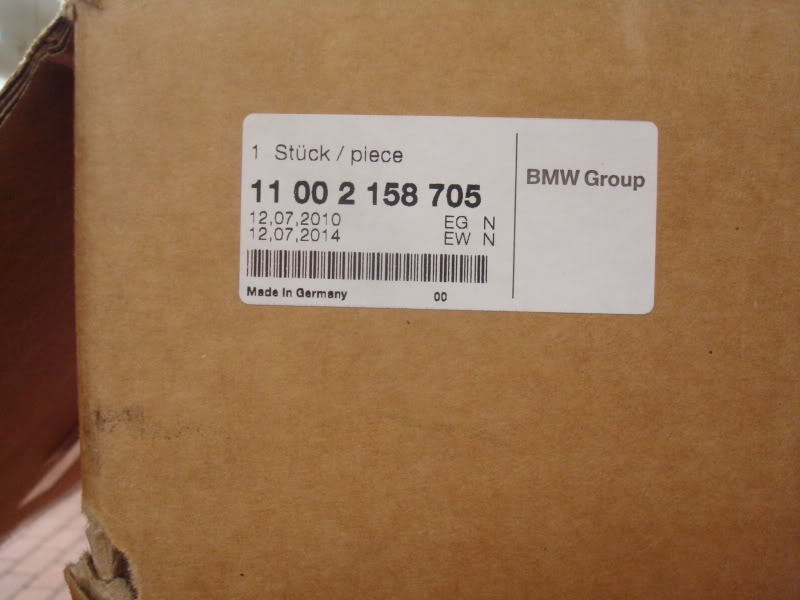

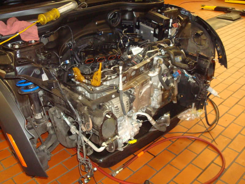

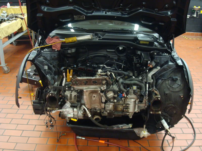

Alright so here's the scoop on what happened. The vacuum pump on the exhaust side of the cam which powers the brake booster and something else I don't recall (timing?) failed which caused the timing chain sprocket to detach from the cam, this allowed the timing chain to fall to the bottom crank and do some damage down there. Valves were bent, shards of vacuum pump and chain pieces lodged themselves along the crank shaft and sprocket. They found that the oil filter had collapsed and the correlation between the 2 is unknown.
It was interesting to hear that the cost to rebuild the motor and the labor involved with dismantle/reassemble outweighed the cost of a new long block that would simply bolt in by $300. So in what I am calling a good thing, I get a new engine with a 2 year warranty for parts/labor. The maintenance program is not extended however, which is unfortunate, but understood.
I'm glad I just took it in just a couple weeks prior to have a complete look over of the car and there were no issues, oil was good and to be replaced in another 2,500mi per the service report Things are going good with the install and I am to have it on Saturday.
Here are some visual aid:

WTF?!? A cam gear falling off. That is random as hell right there.

Random you say? Well look what pops in with 1 search, same exact thing happened to this guy!
http://www.mini2.com/forum/second-ge...e-failure.html
