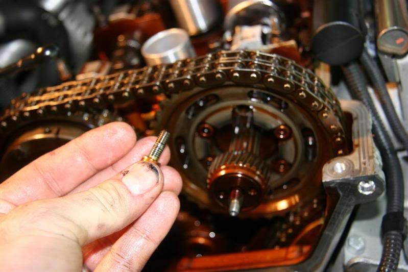

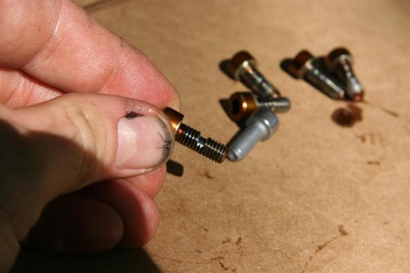

BMW has a very similar problem
To be honest, I suspect it's probably also the cam gear's screws. It's a major BMW problem and BMW knows about it and there's talk of a class-action lawsuit. So now wondering, did BMW also use the same screw manufacturer?
In the M3 world, it's known as the VANOS issue, where the cam gear also becomes loose as the screws either wiggle out and or they become worn out and soon the cam gear gives away and all heck breaks loose. It's become a DYI to prevent their engines from grenading.
See the pics and you can view where the screws are wearing out, sometimes it's just one with many times most of the them. Sometimes there are warnings signs but many times, the engine's blown and too late to fix. The new "fix" is the replacement of these bad screws with brand new ones that have been made "stronger and better". But BMW stealership's will NOT do these repairs, unless you want to pay them dearly. There's been no recalls so far, which sux.
From a BMW forum site, the possible issue: but the loose bolts are the ones that bolt the cam gear (timing chain) to the camshaft. The bolts are worked loose, but cannot fully come loose because of the VANOS adjustment gear and spring that are bolted over top of them. So they are in a loose state, and the timing chain cam gear is moving back and forth ever so slightly on them. This movement is what I imagine causes the "sawwing" effect. Over time, I guess they get sawed completely through, or else they get weak enough to just break.
From reading the OP's repairs done, cam gear "falling off", timing chain came off somehow......I wonder if the OP can quickly get a hold of the old parts replaced but in particular to look at those cam gears, timing items and especially the holding screws.
Attached Thumbnails So My R56's Engine Went FUBAR-bmw-vanos-screw-a.jpg   So My R56's Engine Went FUBAR-bmw-vanos-screw-b.jpg
