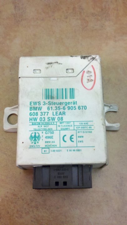

Here was the primary culprit.
Finalizing this no start issue. After the accident the EWS module fryed along with blowing the B+ battery cable. Sitting for extended period the alternator frozeup. The EWS module from what I understand so far controls security starting the car with the correct programed key.
This will be my last post for this thread.
I hope this may help someone.
If ever a question feel free to add to thread & i'll try to help out.
