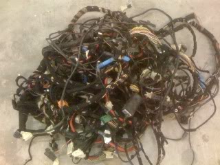

Healey67 is a buddy of mine that I invited to join the thread in an attempt to get you running. He KNOWS MINIs. Here is a pic of the infamous $300 B+ cable.
the small black wire connected to the battery end is tied to the airbag system. When the airbag deploys, a signal is sent to the black box on the battery end. A charge goes off and the circuit is broken. The other end pictured is the "BATT +" box on the drivers side of the engine compartment. It is tied directly to the starter.
Other electrical funtions are carriers on a separate positive cable that is unaffected by airbag deployment. It can be found in this mess:
look closely for the large red cables.
The high cost to replace the B+ cable is due to where it is located. One must remove the cat-back. Remove much heat shielding, remove left front wheel and wheel liner. There may be more that must come off that I didn't notice because I had already removed it.
Greg
