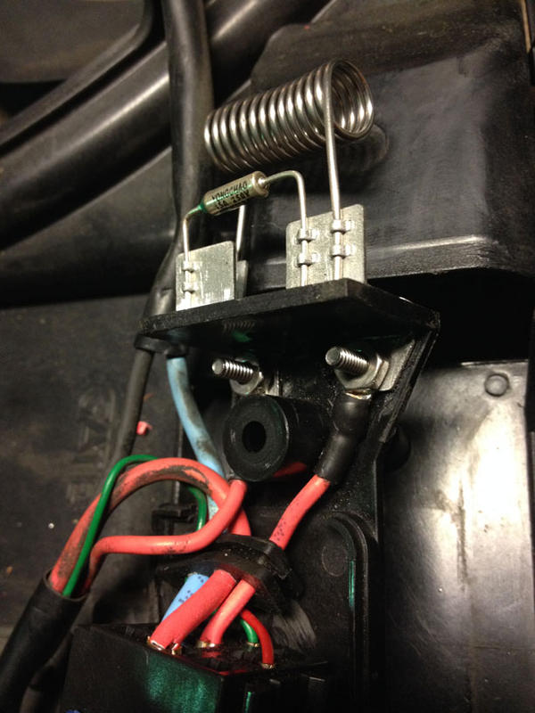

Originally Posted by ZIPPY "S"
Another thing one might want to check is that your power steering pump fan under your MINI is free and not locked up! Because this runs on the same circuit as your cooling fan as your radiator. Also check and see if the 5amp fuse under the bonnet isn't blown. If memory serves me correct there are 2 5amp fuses. One usually is blown. If that is blown your fan will not work. And it is a sign that your power steering pump fan is stuck. If you have a 2002 MINI most have this design.
This is what I did.

Originally Posted by tummi_gummi
This is what I did.
Okay.. I see what you did. Did you soldier or crimp the wires together? Just make sure whatever you did that you have a good connection. I think what you did there should be fine. Very similar to what I did.
I used a male and female spade connectors. It was very right then electrical taped it to seal around it .
Awesome you should be on your way then Only thing different is I used shrink tubing. Good luck!
This is what I did.
That's a thousand words. Photos are awesome. Glad it worked out.
