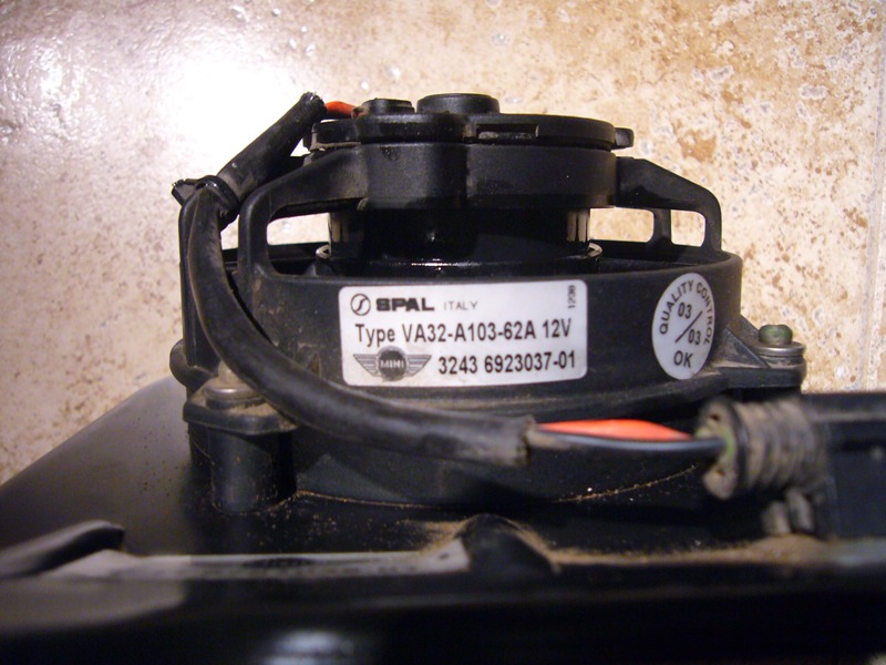

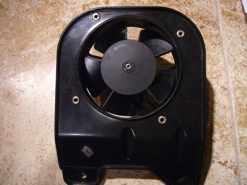

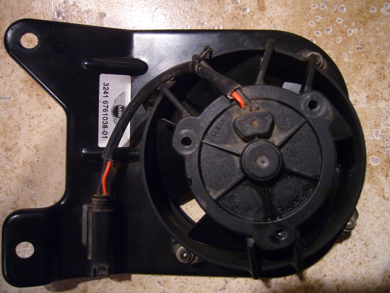

Power Steering fan
Here are a few pictures for those that don't know what the PS (--which could mean "piece of **it") fan looks like as well as the manufacturer.
In the last two days I have changed my oil (Royal Purple), replaced my oil drain plug with a drain valve, changed my transmission fluid (Red Line), new plugs, wires and reset the computer. Around 7pm last night I finished up and took it for a spin. DRIVES AWESOME. Then an hour later I get in, start it up and get ready to drive it to the store...all of the sudden (while still on my driveway) I hear a high pitched noise coming from my engine, so I turn around and head back to the garage, look underneath and realize its the PS fan. I researched and researched on how to quiet thing up and come across a post on ZDNET which says that the way to quiet a computer fan (which this is just about the same thing) is to put 3in1 oil on the fan. I dont have any 3in1, so I put a few drops of synthetic oil on it and VOILA. its quiet. Why do things like this happen the night before you go to work? I have a 2hr. commute each way so I will see if that did the trick. Here is the manufactures website
http://www.spalusa.com/store/main.as...&item=30103009
and here is the blueprint for the fan
http://www.spalusa.com/pdf/30103018_SPEC.PDF#view=FitH
Has anyone thought about a small marine blower in place of this small fan? It would keep the PS from getting hot and they move WAAAAY more air. http://www.boatersland.com/blowers.html I am sure someone out there could figure out how to retrofit the blower in place of the fan.
Attached Thumbnails Power Steering Fan-power-steering-fan-back-view.jpg   Power Steering Fan-power-steering-fan-front-view.jpg   Power Steering Fan-power-steering-fan-side-view.jpg
