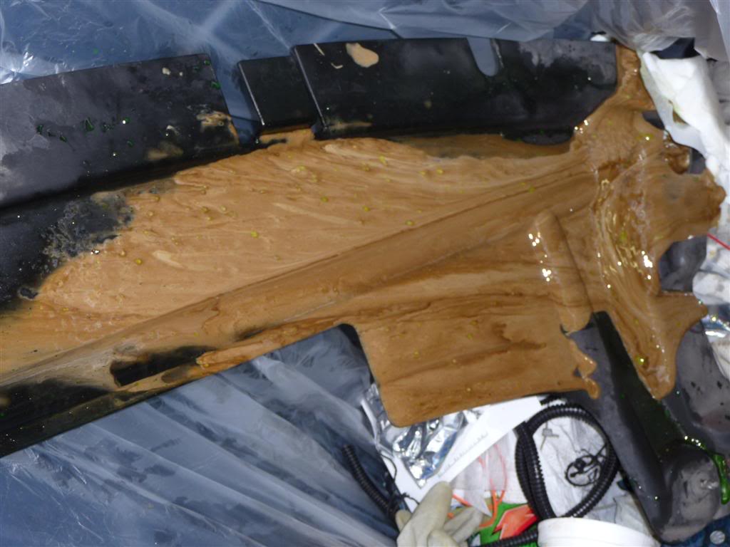

We had a customer come in with an R53 that had overheating problems. He was concerned that the head gasket was blown -- the coolant had engine oil in it. We did a compression test, and everything was fine -- the head gasket was sealed tight. We then pressurized the cooling system, and again found no leaks. But...the coolant was REALLY contaminated. We decided the only possible way this could happen was that the oil-to-coolant heat exchanger had cracked. I've seen this happen on other cars, but hadn't seen this before on a MINI.

So, why didn't pressurizing the cooling system show us this leak? Perhaps because our pressure couldn't make it through this:
That's a picture of the radiator hose. The peanut-butter looking stuff is coolant, which has gelled from the oil contamination. The entire cooling system was full of it.
Some poured out on the belly pan when we opened up the radiator hoses and forced some pressure in...

We declared the radiator a lost cause -- the stuff was packed tightly into the tubes. For the rest of the system, we built a little setup we dubbed the Dialysis Machine. It's a pump we rigged up with a bucket of detergent mixture to flush the system out. We ran through about six buckets of the stuff before it finally rinsed clear.

So, an interesting case. I'm not sure what to take away from it -- I've never heard of this part failing before, and I have never, ever seen the coolant get SO bad. It was incredible how solid it had become, and how extensive it was throughout the cooling system.

The oil was clean. Oil runs as much as 100 psi at cold start, whereas coolant doesn't exceed 20 psi or so. So if the crack is small, the oil will exit more readily than coolant will enter.

that peanut butter is a textbook case of an 'emulsion'
if all that was bad on the car was the hose and the cooler, that guy should count himself lucky. could have caused a head issue he feared at the start from excessive heat.

Dan don't forget, once you shut the engine off , coolant pressure exceeds oil pressure then coolant can get into the oil. Just for peace of mind, I would change the oil and filter.

We definitely changed the oil and filter -- we'd do that in any case, as you said, for peace of mind.
