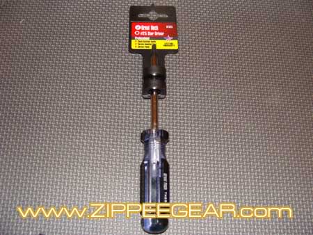

TOOLS NEEDED
- Digital Volt Ohm Meter
- #25 Torx Star Driver
- Flathead & Phillips Screwdrivers
- Pair of Pliers
- Wire Cutters
- Teflon White Lithium Grease or Some kind of Lubricant like WD40
