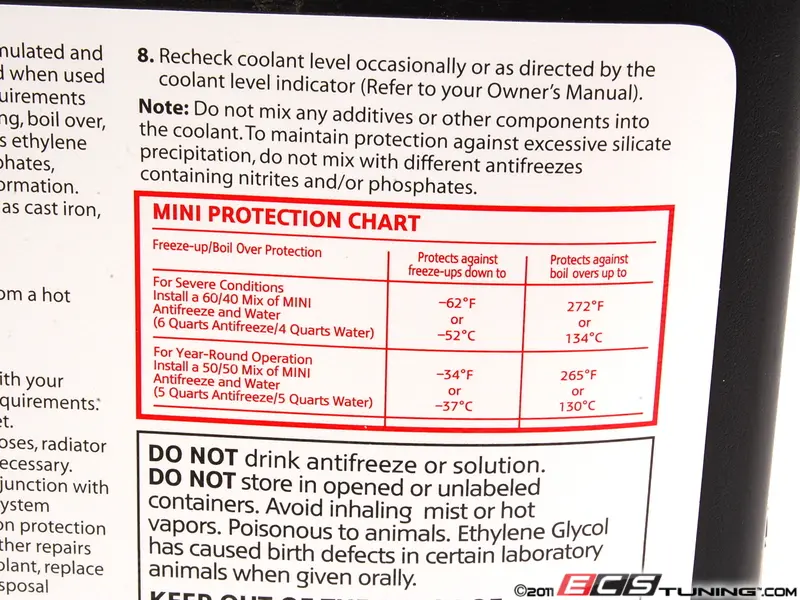

systemshock - Flush it out several times and get it changed back to the blue coolant, mix with 50/50 distilled water. It might take a couple times to get it all out.
https://www.ecstuning.com/Search/Sit...h/82140031133/

2 full bottle of MINI coolant mixed 50/50 with distilled water will do it and have some leftover. https://www.ecstuning.com/b-genuine-...82140031133kt/
Run its till you see clear distilled water if you flush it without new mixed coolant. Then flush out with mix till you see the blue coming out one end. Like doing a brake line flush.
DEI works good: https://www.ecstuning.com/b-dei-part...sh/040202~dei/
So is this stuff: https://www.ecstuning.com/b-liqui_mo...00ml/2051~liq/
Check them out and read up, go with what you prefer.
