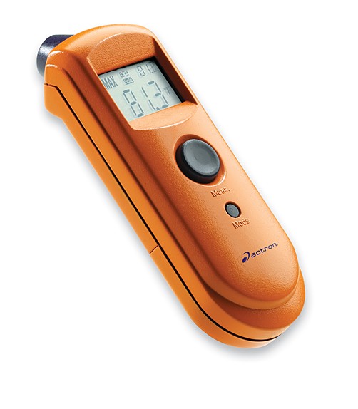

Old Sep 27, 2007 | 05:48 PM
korby's Avatar
korby
Posts: 3,735
From: South Orange County
Do you know where I can get one ?Pep boys has an inferred temp gauge would that work ?
Old Sep 27, 2007 | 06:57 PM
Jinxy's Avatar
Jinxy
Joined: Jul 2007
Posts: 152
From: Maryland
Sears has six different models also. This one is only $39.99
My inlaws gave me this one for Xmas last year. Once you get it you can check out the temp of the drivers side foot panel on the A-frame (where the heater core is located. That's gets up to 140F.
Old Sep 27, 2007 | 07:05 PM
korby's Avatar
korby
Posts: 3,735
Thanks Jinxy I'll pick it up tommorrow !
Old Sep 27, 2007 | 07:20 PM
Jinxy's Avatar
Jinxy
Joined: Jul 2007
Posts: 152
From: Maryland
If the PepBoys model says it's a non-contact IR Thermometer and it's less $$ then the Actron, go for the PepBoys.
You'll be running around the house measuring all kinds of stuff when you first get it:
waterheater and furnace exhaust, your hands, your ears.
I was glad I had it in my toolbox when I first noticed how hot the Mini's bonnet was. If you're a hands on person or all around tinkerer you'll will like having in your tool arsenal.
Let me know what temps you pull off your bonnet. Mine is definetly hottest around the scoop and as you move away the temps drop. But then as you measure near the washer jets the temps pick back up. Not as high as the scoop, but more then the center of the bonnet.
