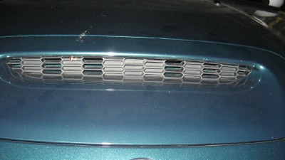

pic of "functinal hood scoop"
Picked my manual MCS up thurday night and have been driving the crud out of it(250 miles) I was aware of this issue and asked my MA if the hood scoop was functional and he said no. When I looked at it every other row was open. I have been feeling the area around the scoop after each drive(keeping under 4500 rpms) it is warm, bot not hot to the touch. I am going to try to get a temp gauge as I like gadgets. I went to my friends house tonight to show him my car and he has a 2004 MCS. The scoop is wider with no slats at all. He had a few bugs on his intercooler but no big deal. So what is the point of the grill?
Wolfgang
Attached Thumbnails Bonnet Heat/Deformed Scoop-img_08981.jpg

Originally Posted by swolfgang
Picked my manual MCS up thurday night and have been driving the crude out of it(250 miles) I was aware of this issue and asked my MA if the hood scoop was functional and he said no. When I looked at it every other row was open. I have been feeling the area around the scoop after each drive(keeping under 4500 rpms) it is warm, bot not hot to the touch. I am going to try to get a temp gauge as I like gadgets. I went to my friends house tonight to show him my car and he has a 2004 MCS. The scoop is wider with no slats at all. He had a few bugs on his intercooler but no big deal. So what is the point of the grill?
Wolfgang
i remember reading somewhere that they only open a few slots due to some sort of airflow/pressure issue... but im not for certain so someone please clarify!!

They replaced my scoop, one with the holes in it even, at 3500 miles because it was melted and deformed. When the new one came in I made sure the tech checked for the ventilation holes in it, and since the replacement didn't have any he put the grill out of my old one in the new scoop. The new one is chrome (I had to pay @$20 to get them to "upgrade") and seems to be holding up much better.
... I have been feeling the area around the scoop after each drive(keeping under 4500 rpms) it is warm, bot not hot to the touch. I am going to try to get a temp gauge as I like gadgets....
Wolfgang
sWolfgang -- You are correct, it's just warm right when you get out of the car. Give the bonnet 5 minutes, then check the area just above the scoop. When I start measuring the temp after I park, the IR Thermometer shows the temps climbing (at certain times it climbs at 1 degree every 2 to 3 seconds). The temp climb slows once it get to 200F, but can creep up to 235F.
If yours isn't getting that hot, then maybe Mini has updated the ECU to make the fan and/or turbo water pump run a bit longer. When was yours manufactured?

Took some temps today
Mine was manufactured 08/07 just got it.
I bought an infared temp today.
After a 20 minute spirited run I took temps every five minutes. (90 degrees F in Dallas today) The hottest temps where at fifteen minutes after stopping. One note the cooling pump thingee stayed on for only 30 seconds after turning the car off.
Temps:
158 F- at the hood directly above the sccop
170 F- at the junction of the hood and the scoop
152 F- on the top part of the scoop above the opening
165 F- pointing the temp gauge into the scoop, but at the middle portion which is blocked off.
203 F- pointing the temp gauge into the scoop into one of the openings.
135 F- at the bottom of the scoop
I could feel the very hot air venting from the scoop, kind of like a convection oven.
I am going to take some more temps to make sure everything was correct.
I read on a post that the dealer has a chrome scoop grill that is fully vented. I think I might get this soon.
