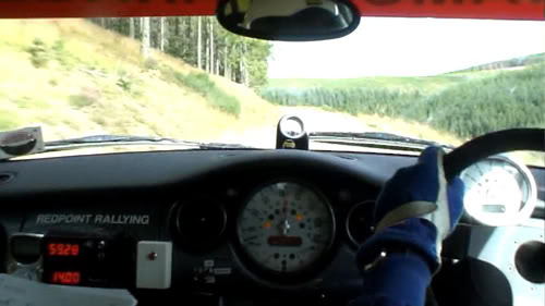

i sponsor a MINI COOPER Rally car over here in the UK...i certainly would say that they can be rallied ! Ive just been sent a 1+ Hour incar dvd of theyre last rally and the terrain was truley awful....but the MINI passed every single stage with no problems at all. (and there were so many cars broken down at the sides of the road it was that bad)
Go for it id say
