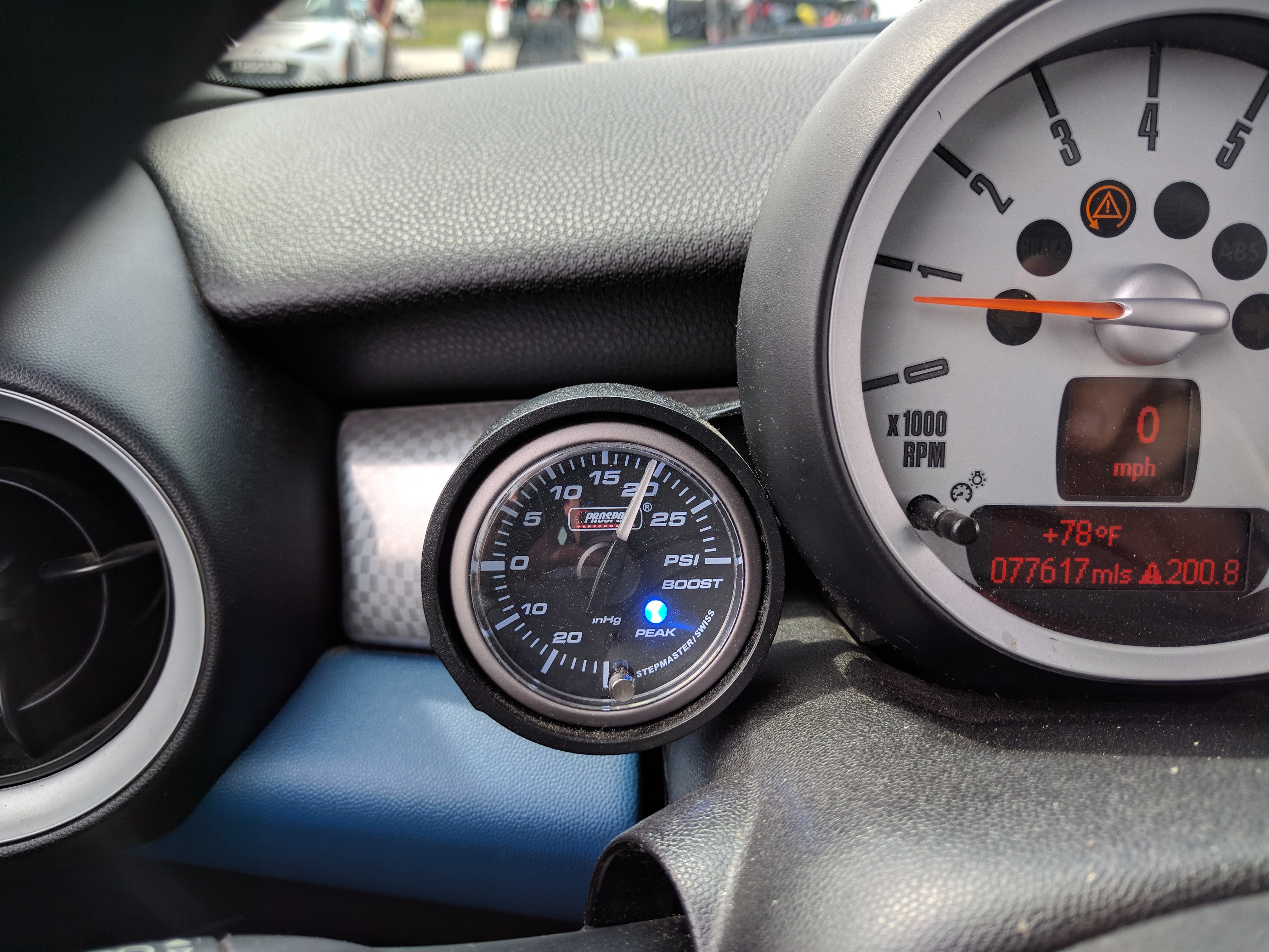

Highest I've logged in my '07 with the non-updated tune. Obviously this is an atypical spike.
On a cool morning it'll be about 14psi in the midrange before tapering off up top, by the late heat-soaked runs of a summer autocross it'll be closer to 17psi.
