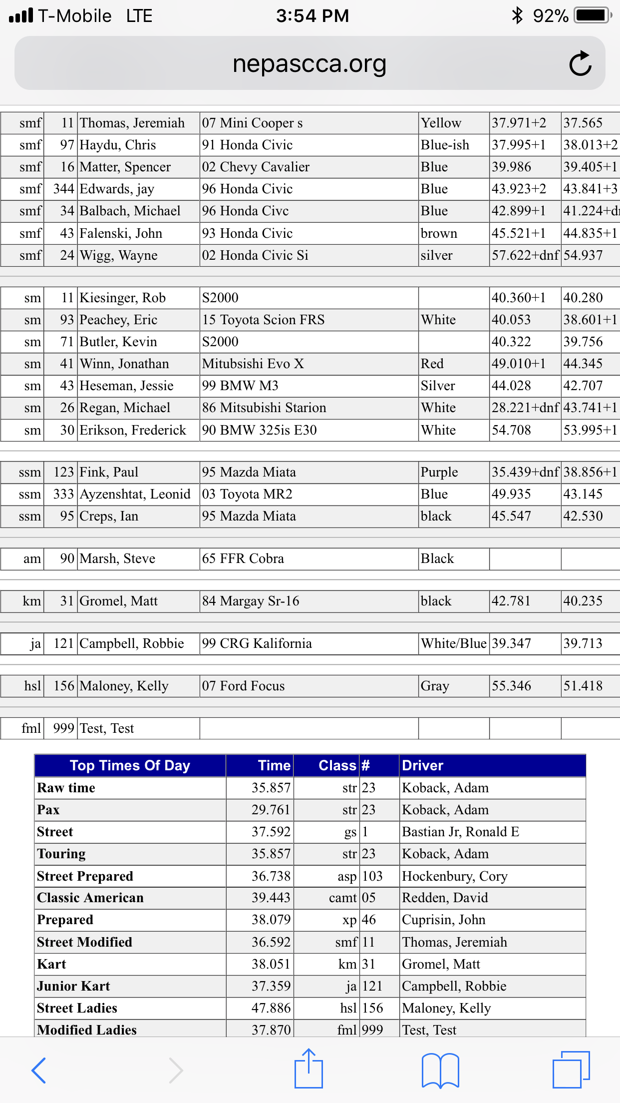

Finished first year novice 1st place
Had a very fun first year autocrossing my 2007 Mini Cooper s with a Manic stage 3 tune with a JCW turbo 244WHP. Won 10 out of 10 entered in my region based on our PAX times.
Last weekend really killed it with my raw times.

Hmm, I have a hard time figuring this stuff out lol. They said go to smf and I said ok. Lol but my last post I did beat the 3rd place solo national driver in smf Sunday.

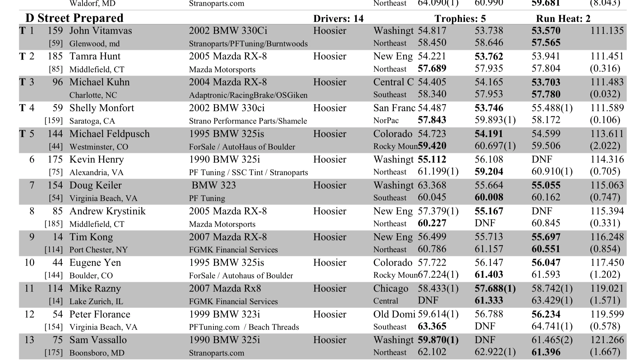

I looked at solo national and compared the classes there pretty even.

Yeah the rules are a real labyrinth, especially SP and beyond.
In P you have to do math to figure out how much your car can weigh. Screw that.
Anyways, I think a DSP Mini has an outside shot on certain courses based on zero real data and gut feeling.
