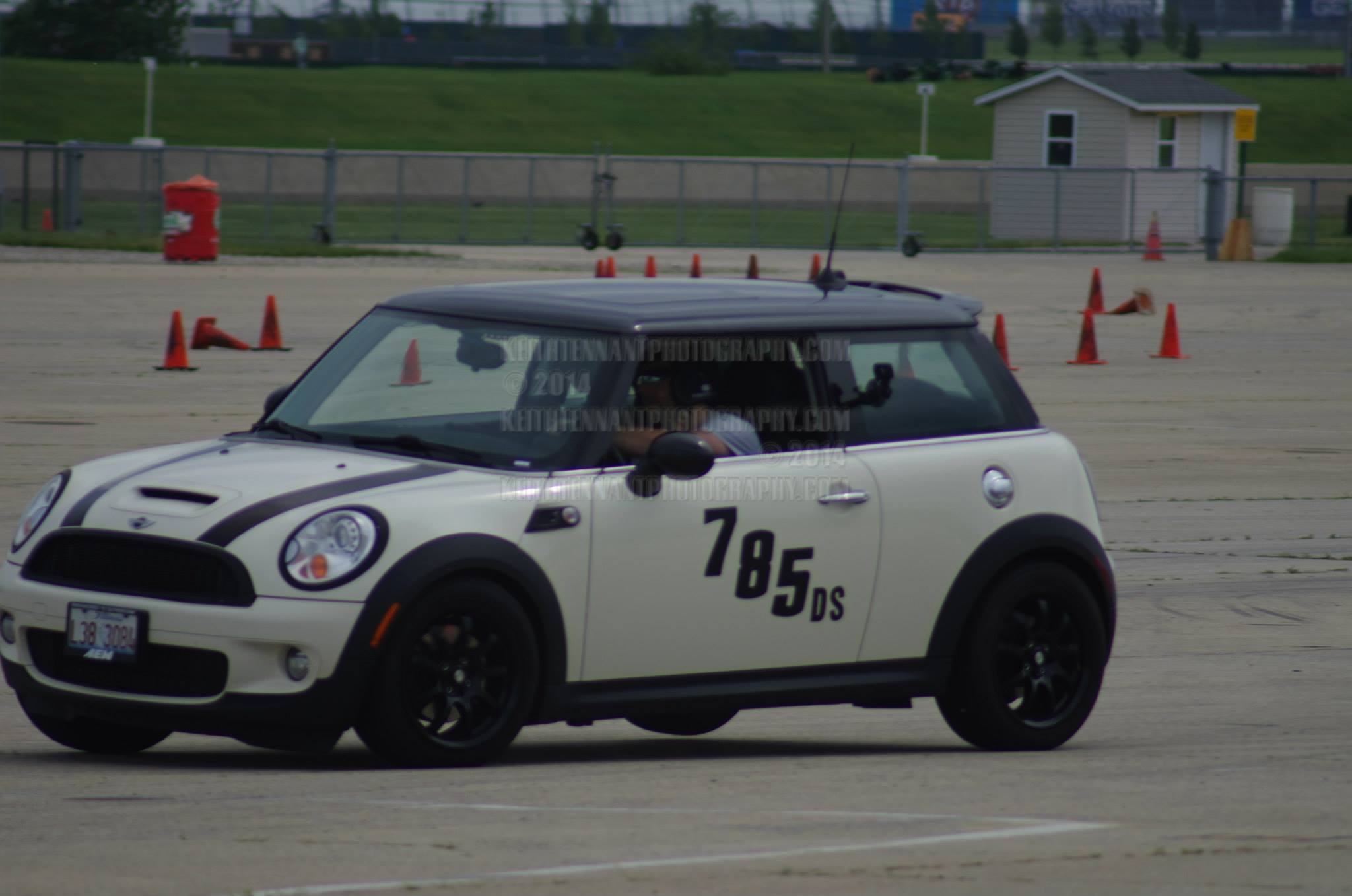

Finally manned up and got my Rear Sway installed. I went with the Hotchkis 25mm bar. Install wasn't as hard as I expected considering you had to drop the subframe. I only removed the two right side bolts so I could allow the subframe to drop enough to slide the bar out. I also only removed the top 2 13mm bolts on the strut and just pushed it aside.
I've been playing with it while driving but don't feel much of a difference as of yet. It may be because I'm running street tire pressures and the tires roll over alot at that pressure. Next event isn't until September 7th so I have to wait to test it out officially. I have it on the setting closest to the front of the car which should be the most aggressive setting, correct?
Anyone with experience with this bar?

posted in the other thread, but i'm using this bar as well. you won't notice any difference until you're pushing it at autox. stiffest setting is the one closest to the body of the bar. just make sure everything's well tightened down

With the new bar, you'll notice a lot more three wheel action than you did before. doesn't really hurt times, but it's and interesting feeling when you do it for the first time. (assuming you haven't) With my bar on full if I corner a little too agressively you will three wheel. Of course depending on your shock/sprig set up, that may not happen as much. I'm still on stock suspension (aside from the hotchkis bar) so it happens quite a bit.

We used to get on three wheels with the stock (sport) suspension. With the rear bar its more exaggerated and people comment on it (a lot). I can't say I've ever noticed a feeling when it does this, it just cornering.

I actually did get slight lift while I was completely stock so I'm sure it'll be more noticeable now.

Here is my last event. I'm getting plenty of rotation. A lot of it probably has to do with my aggressiveness but this is lowering the rears down to about 38-40psi. I normally ran high rears before I got the sway.
