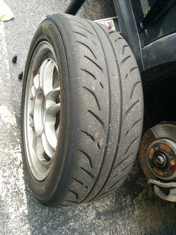

Hi all. So we accept the fact that there is no negative camber from the factory for our MINI’s. I’ve done the “free” negative camber adjustment to my fronts but I am still destroying the outer edge of my front tires when I Autocross. Other modifications to my ride are:
1. Tires are Bridgestone RE-11a 225/45 on 17x7 wheels. Previous tires: Kumho Exsta XS, Hankook RS-3, Michelin Pilot Super Sport.
2. I change pressures at venue and range between 36-40psi up front and 36-42psi in the rear.
3. I have a 3 position rear sway bar set in the middle setting.
4. EBC Yellow brake pads on factory rotors.
5. Koni yellow sport shocks. Front setting for Autocrossing I use 1 full turn from full firm to 1.5 – 2 full turns from full firm. Rears are set to the middle setting and due to location, I don’t change them.
6. As said before, the “free” negative camber adjustment which may be worth up to 1º.
I tend to be “ham fisted” and “ham footed” when I Autocross but I’ve done well with results winning my class and finishing in top 10% for PAX adjusted Fast Time of Day.
How do I stop destroying my tires?
Opinions welcome!
Thanks.
Opinions welcome!
Thanks.

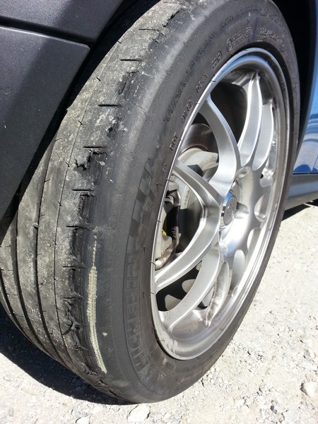

Mini2na: I “chunked” my Michelin’s (see pic) at a track day and couldn’t get DZ II’s on short notice. What other tires have you used for Autocross? Would you recommend the DZ II?
I used to run 40psi up front but my sidewalls still showed rollover wear and I got some better times with less pressure. If there was a 40 series sidewall instead of 45, I’d buy that.
Next event, I’ll bump up to 40’s again and put in some runs.

Those Michelin Super Sports had 44 autocross runs before the track day. During my second 20min session on Atlanta Motorsports Park's main straight, it sounded like I was on a gravel road all of a sudden. I realized the track was clean, but I was making a mess of David Hobb's "Clag" on track. Pulled into pits and moved fronts to rear and finished the day.... carefully.

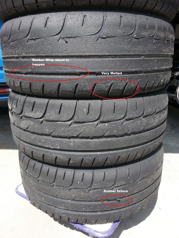

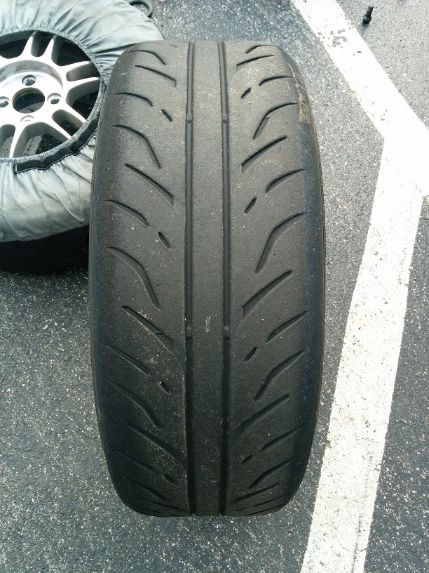

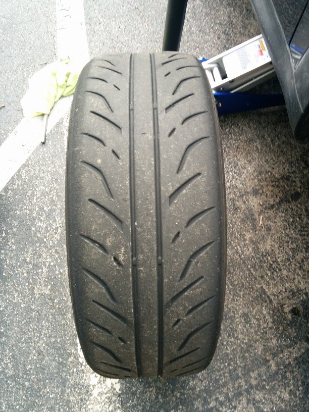

*5/22/14 Update after PDX on Road Atlanta*
Thanks for all the feedback guys! Here's an update:
I did the PDX/HPDE at Road Atlanta this past weekend 5/17 and the car did well. I moved the rears to the front since I've got significant wear showing from 4 autocross events this year. I adjusted my pressures to 40 in the fronts and 41 in the rears. After the two runs I showed 46psi in the fronts and 45psi in the rears hot. The wear is ugly. I have pics attached.
When I drove home, I noticed some odd "flapping" sounds at random speeds. Sounded like some plastic under body part loose and swinging at the car's body. Stopped to check it out. Saw nothing out of the ordinary. I took off the track tires at home and put on my street tires and saw what was making the flapping noise. Parts of the tire are coming off in long pieces. They look like licorice whips (see pics).
I'm tempted to bring them to the tire shop and see if Bridgestone wants to take a look at them as they are falling apart in a structured way. I question the integrity of the tire's construction at this point. I have gone through Kuhmos, Hankooks, and Michelins without this kind of failure. Have any of you seen this kind of rubber/tire failure? If not, then I question my driving as the culprit and will seek out professional instruction to remedy the tire punishment bad habit I have formed.
Also, I made it thru the entire autocross season on my Kuhmos and the following season on the Hankooks. The Michelins.... not up to the challenge. The Bridgestone RE-11a's..... Definitely NOT up to the challenge with only 4 Autocross events and 1 PDX with total track time of 40 minutes.
So, questions to ya'll:
1. What tire can put up with more abuse? R1R, Rivals, Direzza? I understand the Direzzas are done and a replacement is eminent.
2. Will camber plates solve this? Key word is solve. If I leave D-Street class, I will need to go full monty on coilovers, camber plates, etc. to be competitive.
Enjoy the pics and opinions welcome!
We had that happening the first time we tried RE-11A tires. Its one reason why I don't like them (another is I, or the tires, were slower with them, about 2s a lap). The first time we drove away from the track I had to stop to work out what the noise was, the strips were coming away from the rears so badly. After a couple of track days and an autocross, I gave them away.
We've had very good luck on track with RE-11 tires (no A). They're available again as 200TW tires. We had a little of that, but no where near this bad. For autocross, Rivals or ZII have done better for us, we prefer the ZII. I've also used the ZII on track and they do pretty well, at least as good as the RE-11, if not better. You might be able to find some still in stock our 16" were out of stock, but we just got some 215/40-17's.
We've never tried Rivals on track.
Camber plates couldn't hurt, but I doubt it'd fix that issue.
I thought it was clag or picked up rubber at first then I looked at the pieces starting to pull apart from all the tires. It's like string cheese. Look at the piece in picture #2 circled in red as, "rubber whip about to happen". I found 5 more babies like this on the other tires. Can't wait to run my next autocross and hear them slapping and flailing about.
