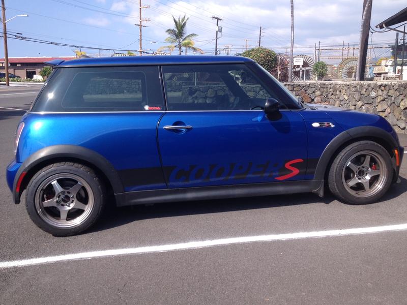

Coilovers, rear sway bar installed
Got the coilovers in yesterday along with the H&R 19mm bar. It turned out to be a long day and I didn't get to work on ride height until today. I also played with the dampening adjustment a bit as well. I started at 15 clicks from hard and then went to 20 clicks from hard, twenty seems to be ok for running around town...especially when my wife is in the car.
Right now there is a "two finger" gap between the tire and the arch and this is as low as I am comfortable going. The splitter is at just under 4 inches and I have already heard it drag a couple of times coming out of driveways.
I still haven't installed the Hotchkiss rear links and I am trying to decide if this can be tackled after work before it gets dark? My alignment appointment is Friday morning.
Roy

Took the MINI to the test and tune. Made no adjustments and was running with the big dawgs again. These changes have made the car seem a lot less dramatic to get around an autocross track. Very pleased so far. Only negative so far is occasionally dragging the splitter over speed bumps or driveway aprons .
Roy
On my SMF Mini Coupe I have just enough clearance to wedge my tire warmers in. So less than a single fingers width I'd say, but with nearly -3deg of camber my 235s barely rub the outside plastic fender. So if you do have clearance issues, camber plates maybe in order.
And remember if its plastic, its replaceable!

I would love to get it down that low but this is my only mode of transport and so I am trying to balance. At this height I never heard any rubbing at the track so maybe I'll lower it at the track for the February event and raise it back up before I leave to head home. I'm running -2 front and -1.5 rear camber right now. With the Hotchkiss rear bars and the Megan adjusters in front I could go further.
I ran the 225 45 Rivals at 32lbs all around. The pyrometer showed that temps were within 2-3 degrees across the tire with the fronts running about 10 degrees warmer than the rears.
Unfortunately the scales didn't make it over to the track so I'll have to play with corner weight later.
