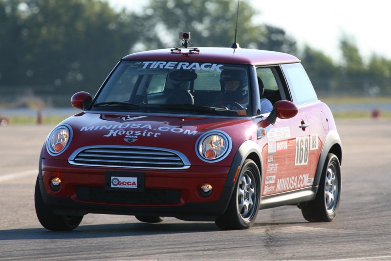

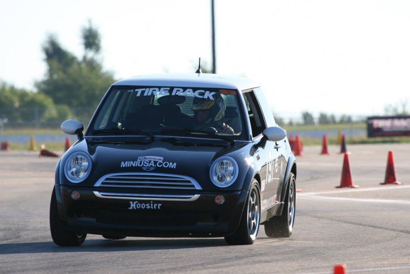

Believe it or not people are running 225s on 5.5" rims. There were a few cars at Nationals this year competing. I know it is possible to wedge 'em on the rims, but I thought there were rubbing issues with the stock rim offset. I bet you need to run a 1/4" spacer (max allowable for stock) to get it to work.
Anyhow, I know these aren't side-by-side photos you requested, but they may shed a little light on how the different combos compare in the heat of battle.
Note: The black MINI won Nationals on the 205/16" rim set up.

LOL, the first pic (red car), is my car at national with my co-driver driving.
I am still debating as to what to run, I know national champ is running the 16s, so is many others. But my past experience with the 16s hasnt be all that good. maybe its the stiff sidewall.

the 225/15 is pinched on the wheel, so you end up with less actual contact patch, and sloppy turn in. ultimate lateral grip may be higher, but would only matter on a course with sustained sweepers.
the 205/16 (hoosier) or 215/16 (kumho) offer much crisper turn in, Hoosier better than Kumho. both are much more precise in transitions than the 225.
the 16inch tires play to the strength of the MINI
