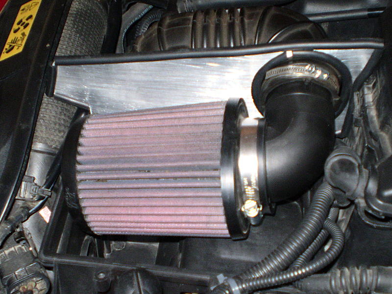

I noticed in your signature you have a custom K&N intake. I'm looking to relocate my battery to the boot and installing the Mini Madness CAI w/ cowl induction & barrier and was wondering if it was STS legal. The battery box on the MC makes up about 80% of the plastic barrier that forms the brake booster area and I was wondering if the removal of the battery box (if you relocate the battery) was STS legal. There would be very little modification (if any) required to do this. Your thoughts?
Always read the rules to be absolutely sure, but in STS you are able to relocate your battery as long as it isn't in the passenger compartment. The battery tray (or battery box, I would assume) may be removed by simply unbolting it.
As for the CAI, be careful that any existing structure of the car is not modified for the passage of ducting from the air cleaner to the engine inlet. Once again, consult the rules to be certain!!!
I will be relocating the battery (also changing to a smaller dry cell type) and mounting it on the passenger side of the boot (which according to the rules is not the paasenger compartment). As far as engine bay modifications for the CAI...I dont belive any cutting or modifications to the car would be required.
Here are photos of my CAI. It's not the most direct path to the throttle body, but it insures the air is cold. I can drive all day in cool weather and then put my hand on the air filter/ducting and it's as cold as the ambient temp. I left the stock air box in place and put a heatshield/fence between the air filter and engine compartment.
Sounds like a good plan
