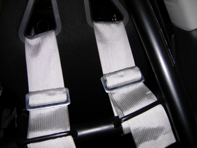

Harness - TeamTech
Some features I really like about these is the built in padding. Check out the TeamTech site http://www.teamtechmotorsports.com/index.html The Energy Pads spread the load over a wider area than normal belts of this type. There is some debate over the sternum strap. The strap connects the two shoulder belts at chest level preventing them from spreading in the event of an incident. Some say this hinders rescue first responders since it's something else they need to look for in order to extricate a non-responsive driver. Others counter that preventing the belts from spreading saves lives.
You'll also note my seats do not have a pass thru in bottom cushion. For me the way I sit and with my physique this is not an issue. It's not ideal when I have a string bean of an instructor with me as there is a chance they could slide forward in a frontal impact. I'm looking at new seats.
Sternum Strap and sewn in padding. It's hard to see the Sternum Energy Pad in the picture as they are black and so is the seat.
Price wise there were a little less than a full set of Schroth or Sparco belts. Price was a secondary consideration, comfort and ease of use were more important in my decision. The shop I purchased them from and that did the install sells multiple brands. They also were very contentious when mounting. Two of the staff climbed over and around me taking all kinds of measurements making sure the angles were all proper. I can't stress enough that proper installation is the key to comfort and safety. If you don't know what you are doing when installing let the pros do it!
Harness guides. One of the issues with a MINI that often the harness bar will have a curve and the outer belt could possibly move in an incident. Guides such as these will prevent that possibility.

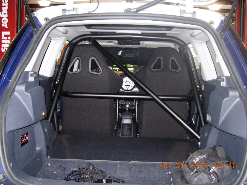

Roll Bar Safety Devices brand from the UK.
If I was to do it again I would go to a local race shop and have one built. This bar is designed for use with a non-sunroof car, we had to modify the legs to make it fit in my sunroof car. The design is really the back part of the full cage and had tabs to mount the halo and door bars. These had to be cut off as they would have protruded into the passenger area.
Rear Mounting Points
I like where the rear section connects to the body with this bar more than I did with the Autopower bar. It does reduce the usable interior space more than the Autopower bar does but I think it mounts to a stronger area of the body.

Couple of thoughts on the posted pics of Nates interior.
First thought is that it just looks like the harness bar is way too low and possibly too far away from the seats. This has been discussed before, by me, and usually targets me as someone who has nothing good to say.
If you are building a track car then make sure you do everything the best way possible. I will tell you that there are some techs, mostly in SCCA and BMWCCA that will not pass that setup. With the death of a Mini driver just last week in an HPDE you can bet that these cars will be scrutinized severely. No joke, you can die if this stuff is not right. I've always warned of this from day one.
Make a plan. Know what seats, bar, belts you want to get. Make sure they all work together.
Nate, get those belts looped correctly!

Yeah, those belts were being adjusted when the pics were taken, since then they have been passed thru again and are properly installed. I should have noted that so folks didn't think it was correct and have issues.
Example of proper belt install.
As to the location of the harness bar. It might be the angle the pic was shot at. When we installed the belts we measured to make sure the belt angles were all within spec. Now this is a problem with an out of the box bar since we are all different sized people.
At the HPDE I attended over Memorial Day weekend with the PCA I asked one of the National Club Race tech inspectors to take a look at my setup. While it would never begin to pass for full race he was quite happy with the current setup for DE's.

Originally Posted by emmathecheesedog
Who makes this cage and where do the rear braces bolt down? Is it on top of the rear shock towers?
