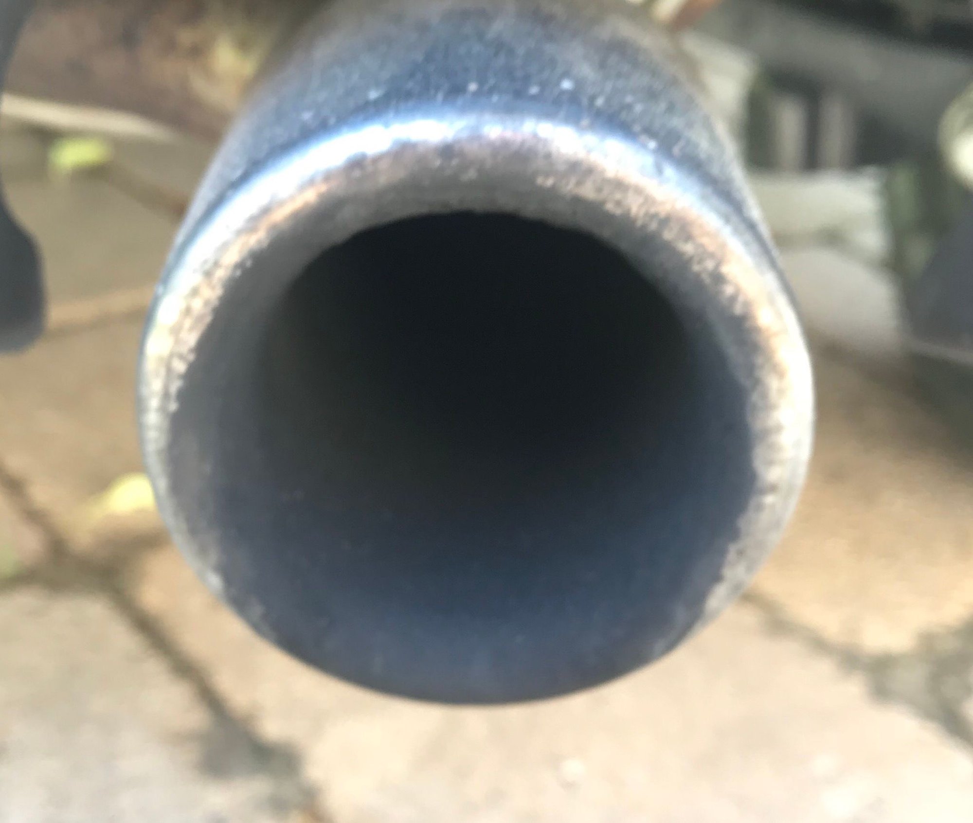

Using steel wool on the exhaust tip isn’t a good idea - rust will eventually start.
this my tip with 61k miles.
I recently bought the car and thought a simple run down with chrome cleaner would work. It didn’t.

They all do that, when the engine is cold, the Engine Control Unit adds extra fuel until the engine warms up. This shows up as soot on the exhaust tips. I just wipe it off with a rag, I have never had a stubborn deposit on my exhaust tips. Maybe it's because they don't salt the roads around here.

I admire your confidence “just wipe it off”...
it doesn’t wipe off. - it’s like baked on carbon that has to be desolved or chipped off.

Well then, why not simply install new tips? Any reason that won't work (welded on?)

No, they will not rust they are stainless steel. Your tips have not been taken care of and are ruined. You can buy new tips at the dealership, just tell them you need “beer can” tips.
I detail cars and know what I am taliking about. If you take care of your car and ceramic coat the tips the carbon washes right off at wash time.
All MINI’s have black tips because they are tuned to run rich and that helps provide the “burple” sound when you back off the gas.

It is a known fact NOT to use steel wool on SS. It is the steel from the steel wool that embeds and rusts.
Barkeepers friend is the best to use on SS.
