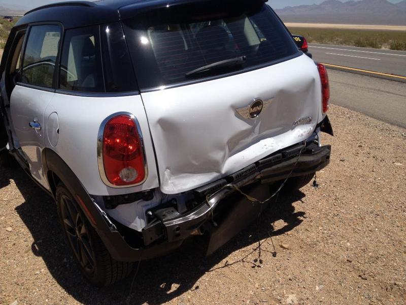

Hi everyone,
I am new to these forums. What prompted me to sign up is an unfortunate event that took place this past Friday.
While my girlfriend and I were on our way to Las Vegas to celebrate my birthday we were heavily rear-ended. We were 50 miles from our destination and I noticed the traffic in front of me to slow down. I began to slow down all the way to about 20-30 MPH. I looked up in my rear view mirror and there was a Dodge sedan about 15 ft or so behind us going at full speed. They did not even brake. I am thinking they were probably texting.
My 2012 All4 Countryman was a little over 1 year old. Basically what I want to know is, what are the chances that my Mini is totalled? I am waiting to hear back from the insurance company but I know it is going to take a while since this occurred in the middle of the desert and my car is at some tow yard out there. The rear of the Mini curled up underneath and the exhaust was ripped in half. In all honesty, I am kind of hoping it is totalled because I know it will never be the same after that heavy impact.
Any feedback would be greatly appreciated. Thank you all in advance.

Wow very sorry to hear about this accident. I am very glad to hear you and your girlfriend are OK.
Unless there is some frame damage I am betting they try to fix it. But ultimately it comes down to cost to fix vs value of car. So if the cost to fix does not exceed a certain percentage of what the MINI is worth they will usually fix it.
Seeing the picture of the other drivers car says a lot of how well MINI's are built.

Since your MINI is still very new, MINIs don't lose value quickly, and the damages are rear... I'm betting it's not going to be totaled.
Rear damages are much less expensive than front damages, of course.
Total Loss rules vary by State. Ask the handling insurance company what the rules are in that State for deeming a vehicle a Total.
(BTW... I'm a auto/bodily injury claim adjuster at State Farm. I handle claims in MD/DC/DE).

I think your MINI will be right on the line of being totaled... Your MINI took a good hit..and honestly it doesn't look bad...The other guys car is totaled IMO.. But the thing with yours is you have to see what hidden damage you have.. Im sure you have some undercarage damage.. You also may want to make sure who ever the claim adjuster is that they look close at the undercarage..Even look close where the exhaust goes into the motor.. Ive seen hits like yours where the exhaust got pushed forcing the motor forward and breaking and twisting things up front even though the car got hit in the back...And the strange thing was that it wasn't noticed until the car was already halfway repaired..That extra unknown damage would have forsure put the car over the totaled limit.. Justs a few things to take note of is all...glad to see know one was hurt....good luck...

But it looks like it'll be totaled, I've seen a few like this when I worked at State Farm but it depends like CJ or person above me wrote, on the States rules, every state is different.

The key will be on how badly the uni-body is damaged. I see a big crinkle at the rear door which suggests the uni-body probably has some bad bends. If the uni-body is bent at any key points such as seat belt attachment locations, then the car should be totaled. Make sure the body shop doing the inspection/estimate, removes the interior pieces/carpets and looks closely at the uni-body damage.
My 2003 MCS had similar side crinkle and was not going to be totaled until they removed the carpet and saw a bend right at the seat belt mounting point which could not be safely repaired.

Thank you all so much for your feedback!
The accident happened in California about 5-10 miles before the Nevada border. I will need to look into the state laws more but someone told me if the damage is 60% of the cost of the vehicle it will be deemed as totaled. I'm not sure how accurate that is.
About the comments on the undercarriage, it looked like the back of the Mini curled up under the vehicle and the entire exhaust was mangled. It also seemed like one of the rear tires was tilted. When the officer asked me to try turning the vehicle on to move it further off the side of the road, absolutely nothing happened when I tried starting it.

Ughh. Just got word for the insurance company that my car "appears to be repairable based on the value of the vehicle". They are estimating the damage to be just over 8k. Yet the estimate says nothing about the frame or undercarriage. The estimate doesn't even mention the rear parking sensors. I dont feel good about the lack of thoroughness of this stupid estimate.
Ask for a list of authorized body shops and get a second estimate and maybe a third. Is it drivable enough such that you can take it to a couple places near your home? When a lil old lady ran into our parked Rav4, State Farm gave me a list of approved shops and I went to 3 of them to hear how they proposed to handle the repairs and each gave me full quotes with all parts (ordered new - car was 2 years old) and labor.

Sorry, but yeah, I thougth it would be repairable.
You are a long way from it being totaled at just $8K in repairs. There will likely be supplemental estimates when they find more damage during repairs but not enough to total it.

2 updates for you guys. 1 horrible, 1 not.
2.5 weeks after my accident with my girlfriend, the worst thing happened. My girlfriend, who also drives a Mini, was on her way to the chiropractor when she was rear ended on the freeway by another girl on her cell phone. Pushing her into the SUV in front of her. She is okay, but this texting while driving stuff is really ticking me off. I wish there was more law enforcement could do to stop these morons. Her mini got totaled and she was emotionally devastated. She customized the car online 5 years ago and was 1 payment away from having it paid off. So sad for her.
On a brighter note, turns out my mini got totaled as well. The body shop told me the drive shaft got destroyed, bent and pushed up destroying a lot of little things along the way.
Thank you all for your advice and comments throughout this dreadful process. Time to go shopping for my new Countryman.
