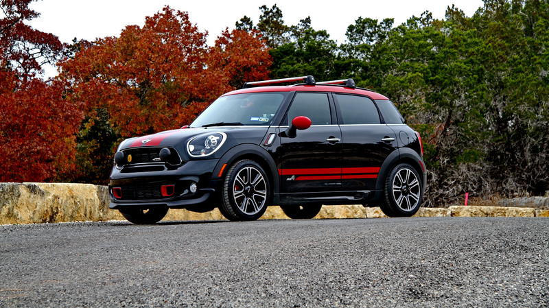

Attached Thumbnails Water Dripping Into Countryman-mcworx-001.jpg   Water Dripping Into Countryman-stock.jpg

Jeez, Stu- That's a gorgeous CTM, and great pix!
