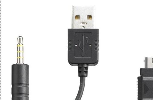

Not sure which one you tried but in theory Pioneer CD-IU51V or CD-IU50V should work. They both have A/V TRRS 3.5mm jacks and USB. I am not sure which dock extender you're trying next but make sure the tip of the 3.5mm jack has 3 rings as per the attached image. On the other hand, if you can live without album art, The standard apple sync/charge cable will do everything else. I should note that after any "mission control" comment, my display reverts from displaying the playing song to the list of external devices which I find extremely annoying.
It was the the cd-iu51v. No workie..http://www.cablejive.com/products/dockXtender.html this is the one on deck....

Are you sure this is the correct link? This dockxtender is a simple extension cable for the ipod/iphone port. It does absolutely nothing and the other end is a male ipod tip. How will that help you?
Male part of extender to phone. Male part of y cable to extender...

Everything worked flawlessly. Should have bought this one to start with. Everything with the connected worked as it should...
