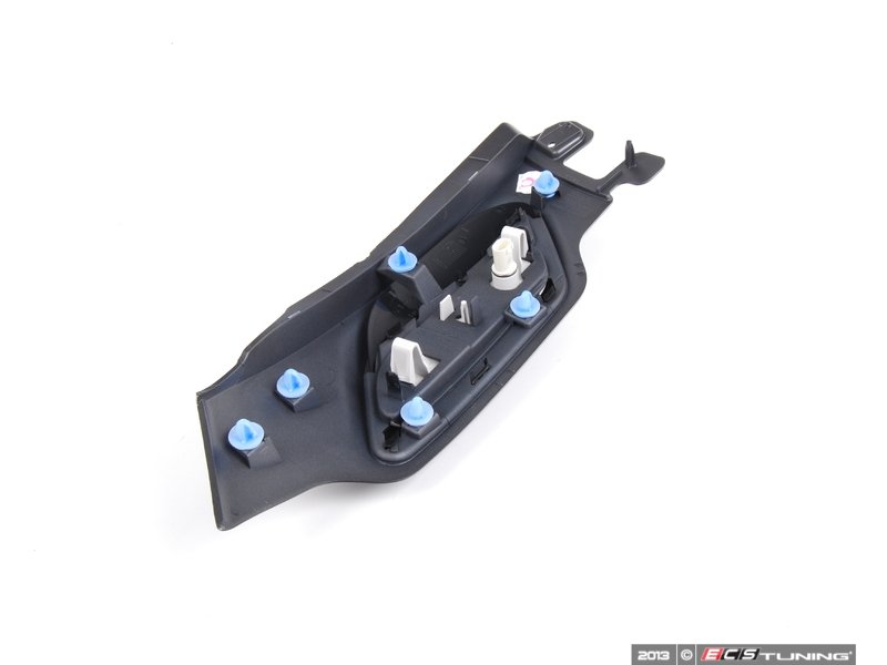

We have the clear ones right here. #1 in the diagram
http://www.ecstuning.com/Search/SiteSearch/63139802569/
Left Side
http://www.ecstuning.com/Search/SiteSearch/63139802570/
Right Side
They look pretty good on the Cooper S and JCW version Side Carriers which are the whole part.
#3 in diagram
Side Carrier Turn Signal Trim JCW - Left
http://www.ecstuning.com/Search/SiteSearch/51139808593/ES2627151/
Side Carrier Turn Signal Trim JCW - Right
http://www.ecstuning.com/Search/SiteSearch/51139808594/ES2627152/
Here what they look like on the Cooper S version side carrier to give you another idea.
Side Carrier Turn Signal Trim S Chrome - Left
http://www.ecstuning.com/Search/SiteSearch/51139804617/ES2136587/
Side Carrier Turn Signal Trim S Chrome - Right
http://www.ecstuning.com/Search/SiteSearch/51139804618/ES2136588/

The JCW trim covers ( inlay ) only comes with the "Side Carrier Turn Signal Trim JCW" whole section as pictured above. You can get other inlays separately in sets. This will give you some options.
Mount set for trim panel: #1
http://www.ecstuning.com/Search/51132208400/
Or you can do just the inserts with the mounting set. #1 .
Yellow Cover Set Part number 51132184062
http://www.ecstuning.com/Search/51132184062/
Green Cover Set Part number 51132184058
http://www.ecstuning.com/Search/51132184058/
Orange Cover Set Part number 51132184060
http://www.ecstuning.com/Search/51132184060/
Blue Cover Set Part number 51132184059
http://www.ecstuning.com/Search/51132184059/
Pink Cover Set Part number 51132184064
http://www.ecstuning.com/Search/51132184064/
Union Jack Set Part number 51132184056
http://www.ecstuning.com/Search/SiteSearch/51132184056/
Black Jack Set Part number 51132184057
http://www.ecstuning.com/Search/SiteSearch/51132184057/

It looks like for the trim covers and multiple colors you can use the chrome mount set. But should fit an other version.
If you look at the back of the black jack set, you can see the tabs. And how they line up, then it should just snap in.
Let me know how it goes and I will try to help.
