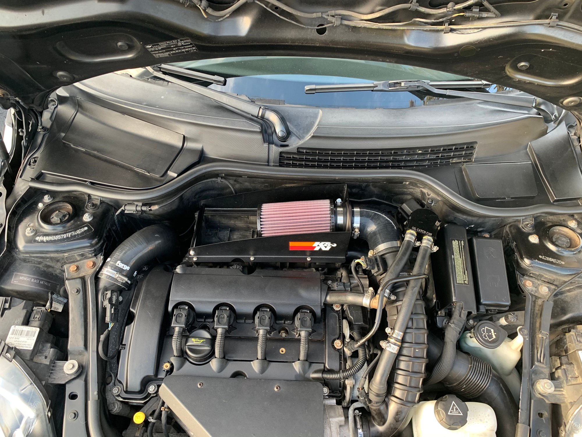

I'm curious what you're dealing with... the N18 AEM intake connects tot he MAF sensor. The N18 intake doesn't replace the turbo inlet tube, but the N14 AEM intake does. The N18 AEM intake is really just an airbox replacement with a duct for the hood scoop.
Here is a picture of my AEM installation:
