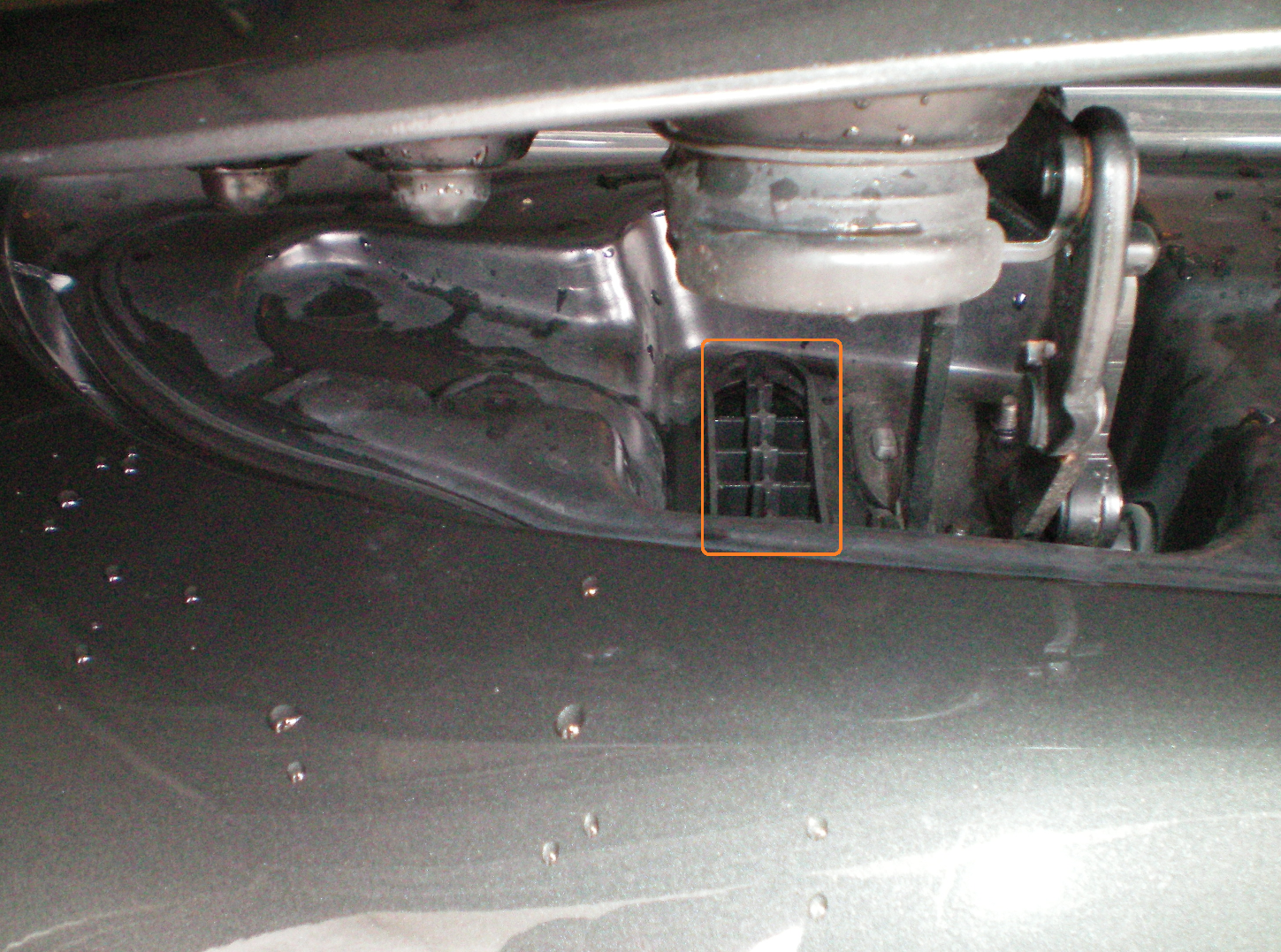

this drain near the wing hinge arm mount

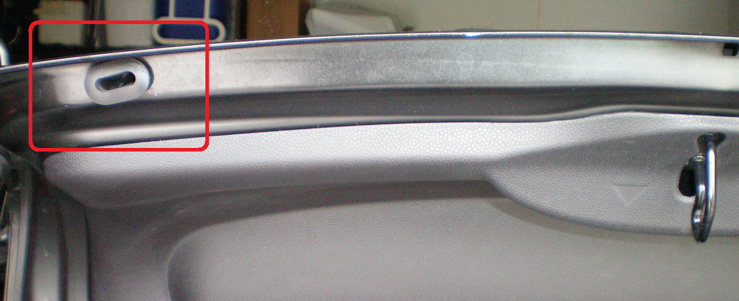

lines up with this drain hole on the lower lip of the boot - one on each side ..... water poured in the drain should run out from under the boot lip and over the bumper
you don't want any leaves or crud in that drain area ... in addition to blocking the drain it would hold moisture around the hinge promoting corrosion and could JAM the wing . . .
