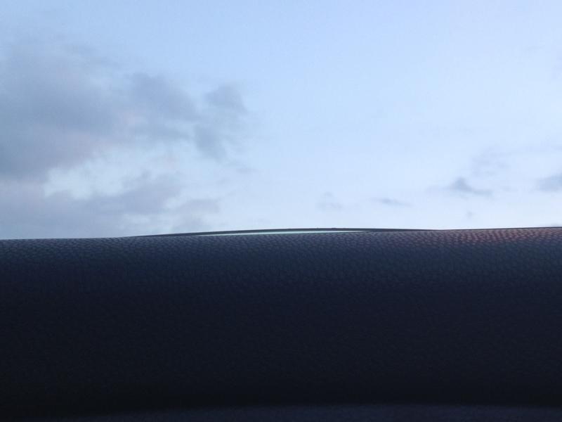

Sent and email to the service rep with a cc to his manger today, hopefully they will try to resolve the issue. I really don't want to be in a loaner for another 3 days without a solution. Heres a pic, maybe i'm too picky.

You may be "picky", but to me, being able to rest your arm on the door with the top down is part of the Roadster experience! While it's not a critical or safety issue, your pic is definitely "Not Normal" (as MINI marketing says)! I just waited until I had a regular service appointment for an oil change, and they fixed it in about 30 minutes. The body shop tech just popped the door panel off and made some adjustments, no parts needed, and you shouldn't have to need a loaner for 3 days.

that is what my passenger window looks like too.

For anyone curious, mini had asked me to do this survey on my satisfaction with the service issue. I ended up going back to the dealer, who told me they have tried and the the window can't be adjusted any lower. I stressed the point that the drivers side is fine, and couldnt see why the passenger side would be any different. I assume its a symmetrical car. They opened a technical case, and had it magically fixed 2 days later. I thought it was funny how what I was told was impossible twice was fixed so quickly. They claim to have adjusted the regulator. They did spend half a day water testing the window as they were afraid of leaks.
