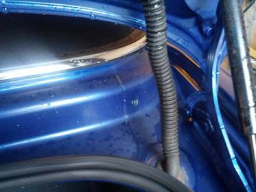

Cleaned the roadster prior to our trip north from the Smokies. My wife noticed the paint rubbing off the inside of the boot lid and the rear body panel. Anyone else see this? I'll get better pix later today.

I only have the bit near the snake...

I found a couple of other small spots, near the "points" of the forward edge of the boot lid. It looks like one of the forward pivots on the hinge is just touching the bodywork, perhaps just with vibration. I'll try a photo this weeknd.

My "snake bite" looks exactly like yours...except for the blue.

Just an update. Went for service this week, and the dealer did three things to rectify the paint rubbing:
1) adjusted the rubber bump stops on the boot lid to make it sit a little differently
2) touched up the rub points with body-colour paint
3) fitted small patches of "clear bra" type film over the rub points to help ensure they don't affect the paint again.

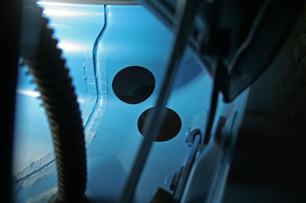

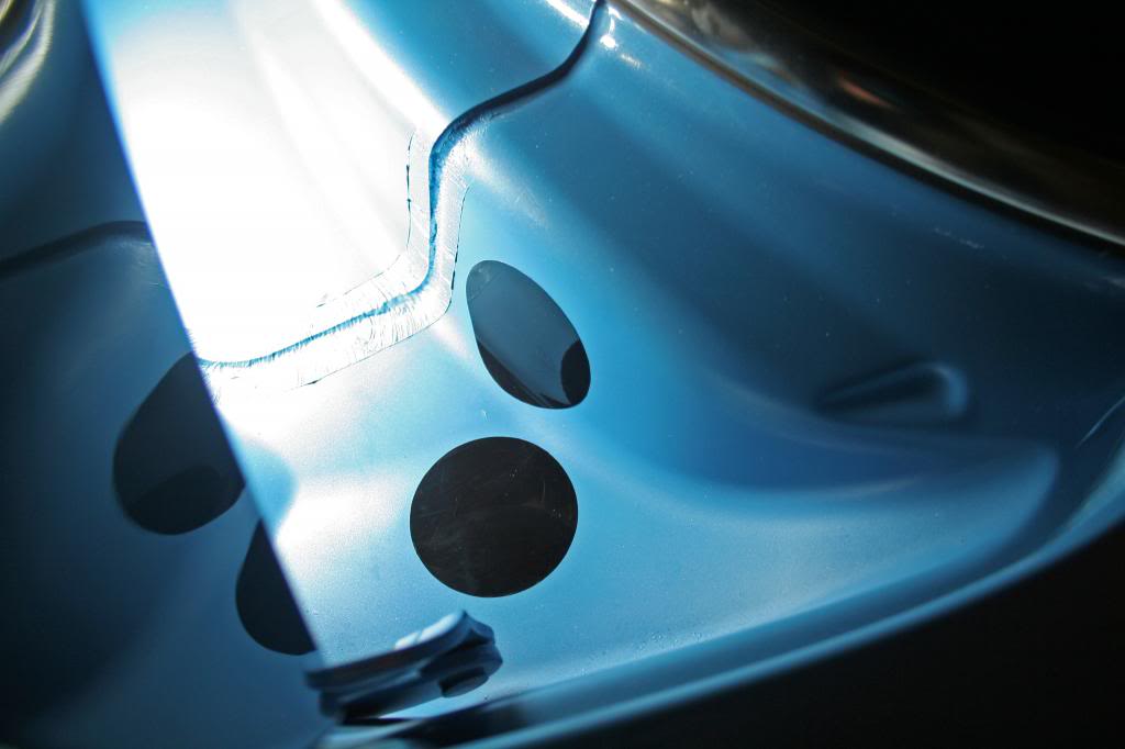

I thought I'd post this here... I had some black gloss vinyl. I made two circular patch with it and placed them where the rubber was meeting with the paint. Fixed . . . for now . . .
