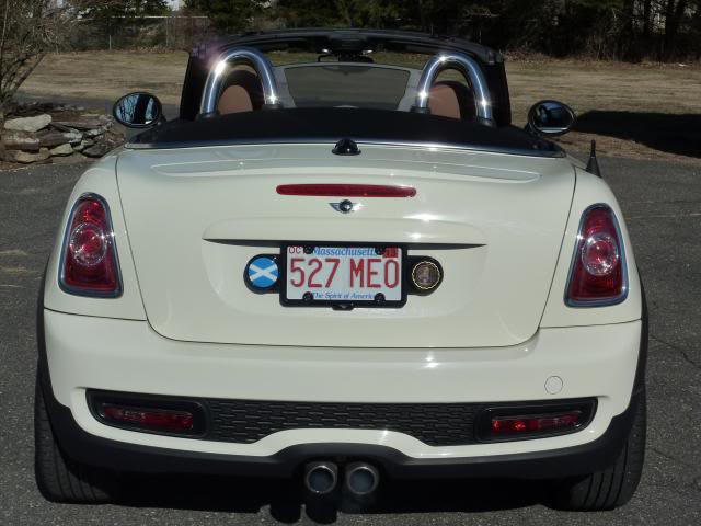

Finally a sunny day with temps in the mid 50's.
I took off the COOPER S badges today.
A little bit of dental floss, my fingers and a couple dabs of goo-gone..

Just how long did it take you to do this work, start to finish?

10 minutes...
You'll break the dental floss half way through the letter. just pull it off with your fingers and when done use a little goo-gone and wipe dry...
very easy.
The newer the car the easier...
Andy
