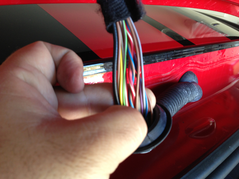

Did you happen to find out anything on this? I am trying to do the same for my R58. Went out this morning and started to take off the rear interior plastic (the one with the hatch pull down handles). Got 4 clips off and was able to see inside to the other clips, and it doesn't look easy, nor does it seem to be the way one would have to get to the 3rd brake light. But maybe it is BECAUSE its difficult...
Then I took the rear handle off (the one with the license plate lights in it. No go there either.
I also started to pry the brake light out gently from the body but it didn't budge. My guess it is screwed in and according to RealOEM.com it does have 2 screw terminals on it.
So after looking around, as of now without knowing how to disassemble easily everything, the easiest way I can see to access the wiring for the 3rd brake light is via the harness that comes from the rook to the hatch. This harness contains all the wiring for the rear wing, License plate lights, 3rd brake light, etc.. I can easily get to the harness by removing the grommet and exposing all the wires, I just don't know which wire to tap into. There looks to be enough room to hide the pulsar within the hatch or roof (wrap it in foam to keep it from rattling).
Does anyone have the service manual to confirm what wire is what, or know a resource I can get that info from? I installed it easily on my R55, would the wiring color be the same for my '08 Clubamn to my '12 Coupe?

So looking at my Clubman it looks like yellow and brown that go into the connector, then red and black out of it.
There is a yellow on the harness on the coupe and 2 small brown wires and 1 large brown.
If I remember correctly. All browns are 12v constant? The thicker brown is probably the motor for the rear wing. So if I tap into one of the smaller browns and the yellow should this work?
Z
