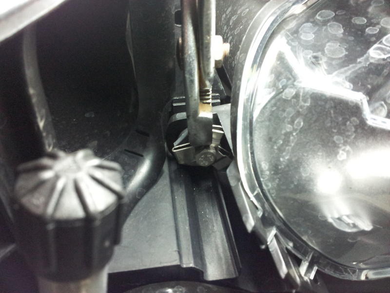

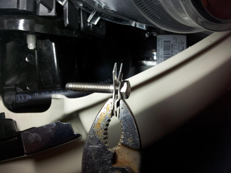

You’ll need to remove the headlamp via four 10mm bolts (2 facing up and 2 facing forward).
Three have a tri-wing spring washers that kept getting stuck on the threads, so I held them closed with some pliers.
Do not rotate the fat grey nuts the bolts pass through. They aim your lights and keep them centered in the hood opening.

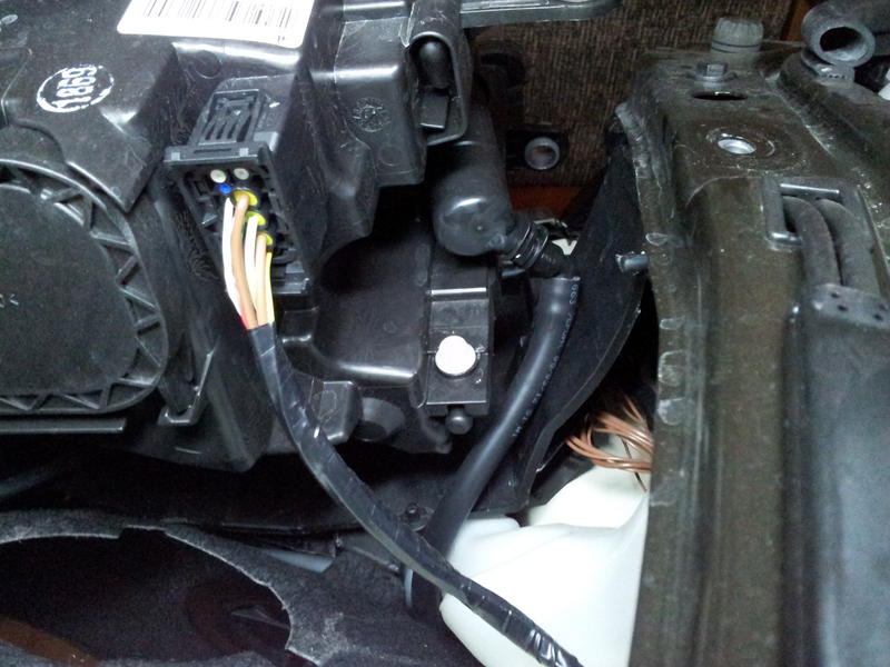

Now the headlight will lift slightly and pull forward. There is one wiring harness (pinch top and bottom and wiggle back to remove) and one hose for the headlamp washer (push the button on top of the clamp, and it’ll unclip towards the engine)
Got it out, now set it upside-down on a pillow or something so the lens doesn’t scratch.

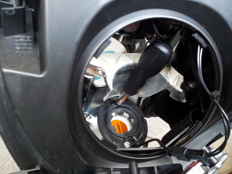

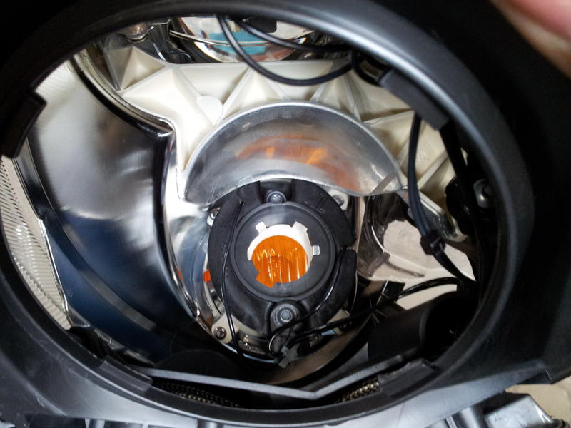

Twist off and remove the access cover from the back and then twist and remove the bulb holder underneath.
You should now see the black plate on the back of the reflector dish, held in by two T25 Torx screws (it’s wired for the bulb holder). The top one is a tight fit but doable.

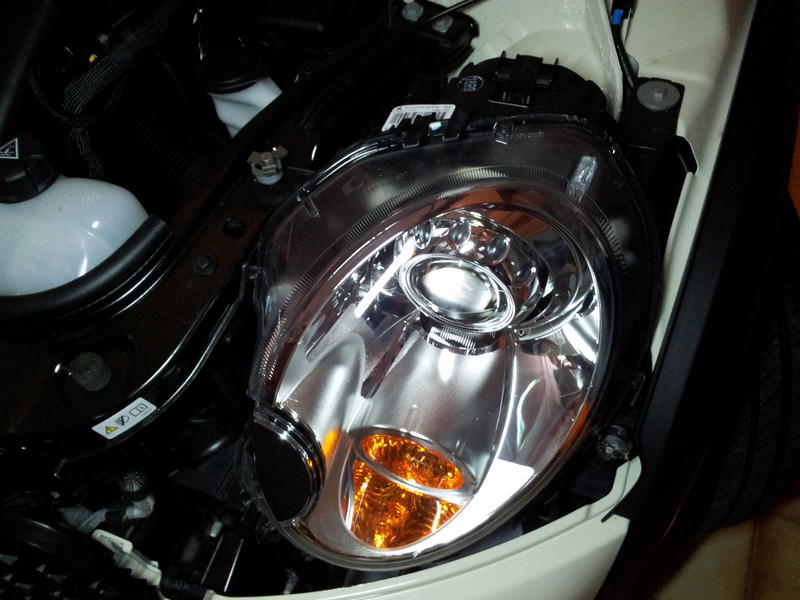

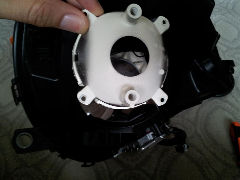

Once the screws are out, the black plate slides off 2 posts. It’s a tight fit, but carefully rock it back and forth while pulling straight back. One of the posts is keyed so it only fits one way.
You’ll now see the white back of the reflector dish held in by 4 T10 Torx screws. The top two are the problem. They are right against the curved plastic and blocked by the (power adjusting) Xenon mount. My T10 driver would barely grab them and fit at a 15 degree angle. You’ll need a new good quality T10 driver (or even a T10 ball driver). It has to be narrow and pretty long to get in there. Either way, these 4 screws come out (and eventually have to go back in).

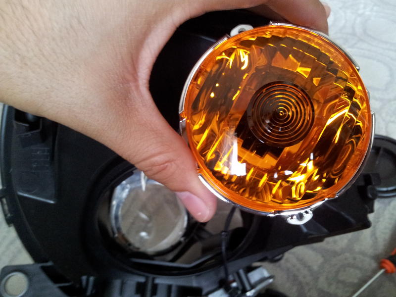

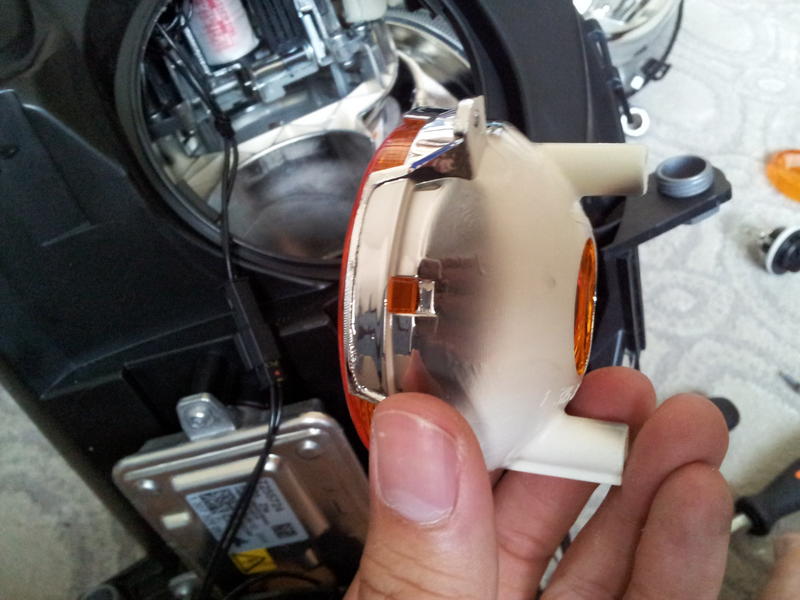

Once the four screws are out, the reflector and lens come out together. There is a tab on either side that you can press in slightly and push the lens forward.
Always push from the back to avoid scratching the mirrored plastic. The orange lens will pop off and you're about there.
