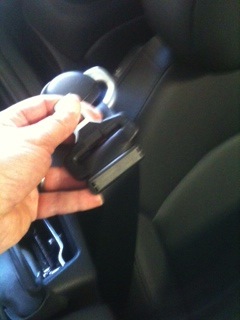

Old Jun 3, 2012 | 02:49 PM
user 739030's Avatar
user 739030
Posts: 167
From: Jersey shore
I finally figured out a solution to the seat belt rattle. There is a stopper piece that slides up and down on the belt. Adjust it so that when the belt is all the way back to the pillar, the clip is at the very top of the pillar. Therefore it has nothing to rattle against.
Attached Thumbnails What Is That Roadster Rattle?-image.jpg   What Is That Roadster Rattle?-image-1.jpg
Old Jun 3, 2012 | 03:08 PM
BlueToy's Avatar
BlueToy
Joined: Jul 2010
Posts: 1,476
From: Chicago
Good idea...thanks
I just started doing this for the rear seat belts in my wife's Clubman. They were rattling constantly and this has tamed it to the point where it doesn't bother me any more.
