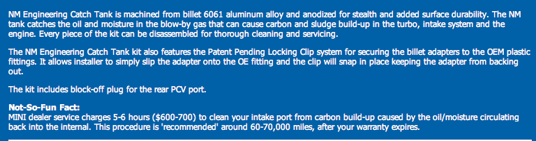

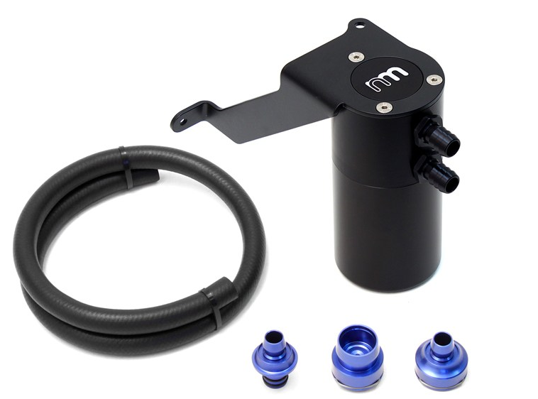

NM Billet Catch Tank
I finally got around to getting my catch tank installed. As with all NM products, extremely well made, and their connectors made the install very simple. Nice knowing it's there keeping the intake track clean. Here's a look...

That engine bay is unbelievable! So clean! You have how many miles? Looks great - better than new!
So what is the Catch Tank for? Is that off the crank case breather?
Thanks!
Franny

Hi Franny,
I figured this would be the easiest way to explain it.
The last paragraph says it all

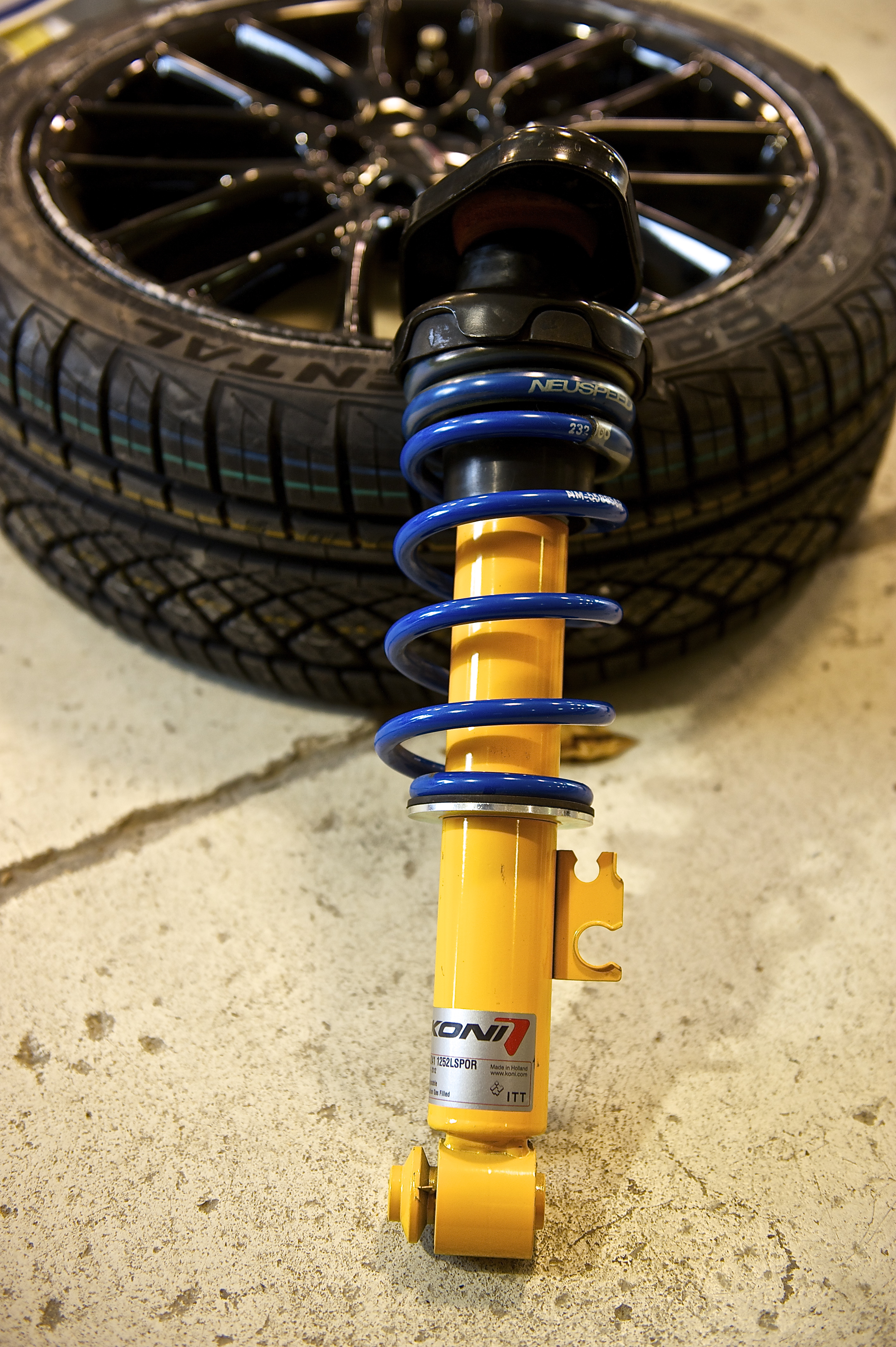

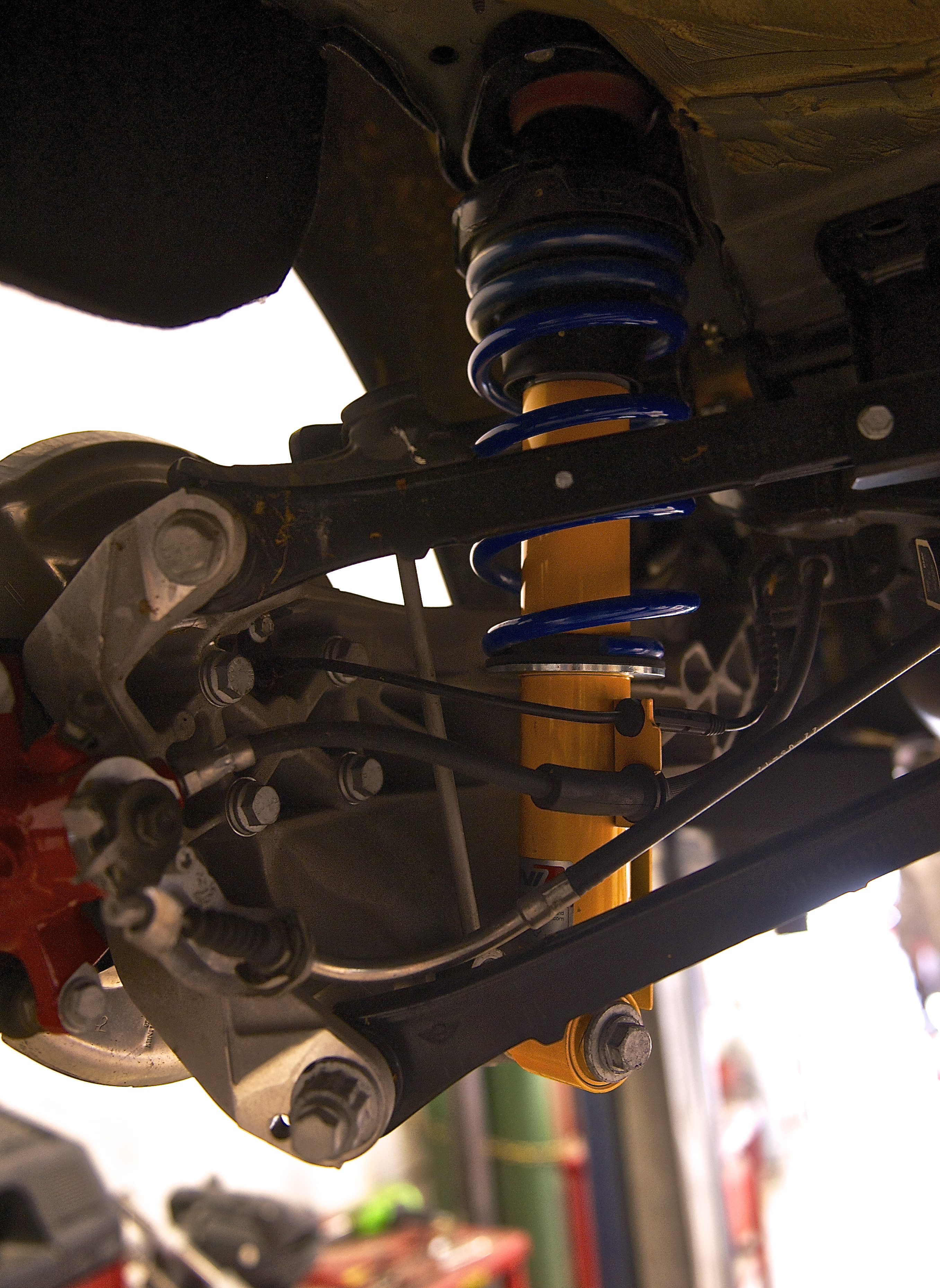

Koni Yellows
I made some changes to the suspension today, I replaced my factory "Sport" struts and shocks with Koni Yellows. I had been running the stock strut/shock set up with the NM Alpha springs. Lately, it felt as though I was blowing right through the stroke on the struts. I had read some really good reviews of the Yellows, especially when paired with the NM springs. This was also the recommendation from NM.
On the rack again
The Koni's made a huge difference, noticeable from the first few minutes behind the wheel. The ride feels firmer, but a lot more "planted". There is no noticeable dive/squat during braking and cornering is nearly dead flat. This combo reminds me a lot of the KW V2's I had on my R52. I'm currently running them at the middle setting, I'll continue to experiment with the settings to get a good feel what they are capable of.
