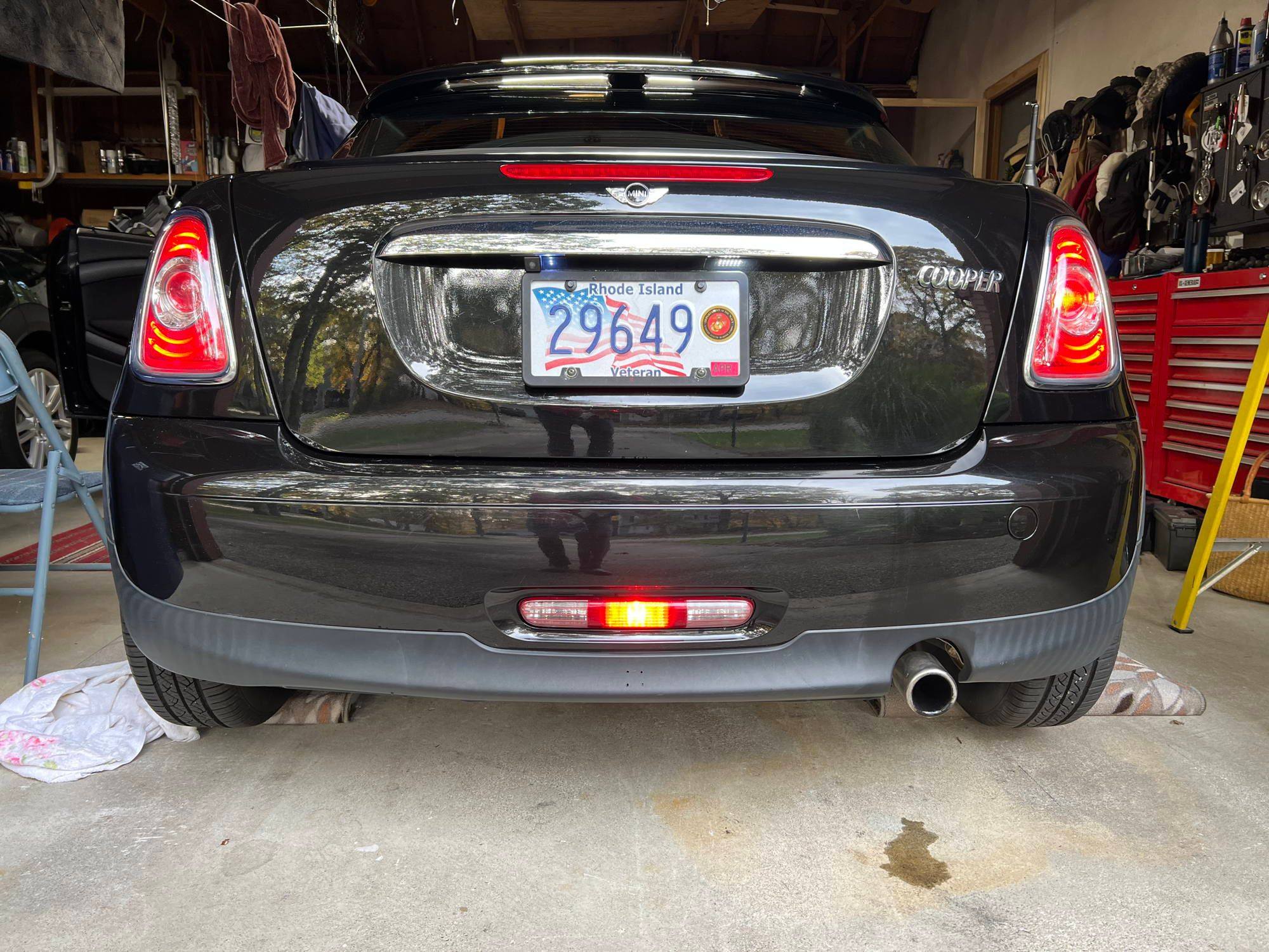

Today was a programming day. Earlier this year I had attempted to change a few coding options, using Bimmercode and connecting via OBDLink's CX OBD2 bluetooth adapter. I could only get two code changes to work consistently (double-blink emergency flasher, no bulb-out warning light with LEDs), but with every other option I tried, the change either wouldn't "stick" or just didn't work. I figured it was due to the aftermarket Android 10 head unit I had installed screwing with the CAN-BUS architecture. Maybe. So I ended up throwing in the ECU towel and punted the task over to CodeMyCar.com, who for a fee would do all the code work remotely, using an OBD-Enet cable connected to my MacBook via USB. I had to install software provided by CodeMyCar to allow for remote access into the Coupe to implement the coding changes. Bottom line here is that all the functional changes I had been looking for were enabled by CodeMyCar, and so far everything is looking good. The changes made include:
  • Open and Close Windows remotely using the key fob
  • Re-enable One Touch Up Feature For Windows
  • Unlock Doors When Car Is Turned Off
  • Enable Power Windows When Car is Turned Off
  • Disable Window Safety (Allows One Touch Up Window Operation While Door Is Open)
  • Enable Fog Lights as DRLs
  • Double Hazard Flashers/Eurohazards
  • Disable Bulb-out Warning Lights from LED lamps
  • Prevent Potential Light Errors that could be caused by my F56-style LED projector headlights
  • Enable the Rear Fog Light (I had already installed the toggle switch in the center stack)
I'm pleased with the work - entire process took several hours and my personal level of effort was minimal after I connected my computer to the car.
Rear Fog Light enabled

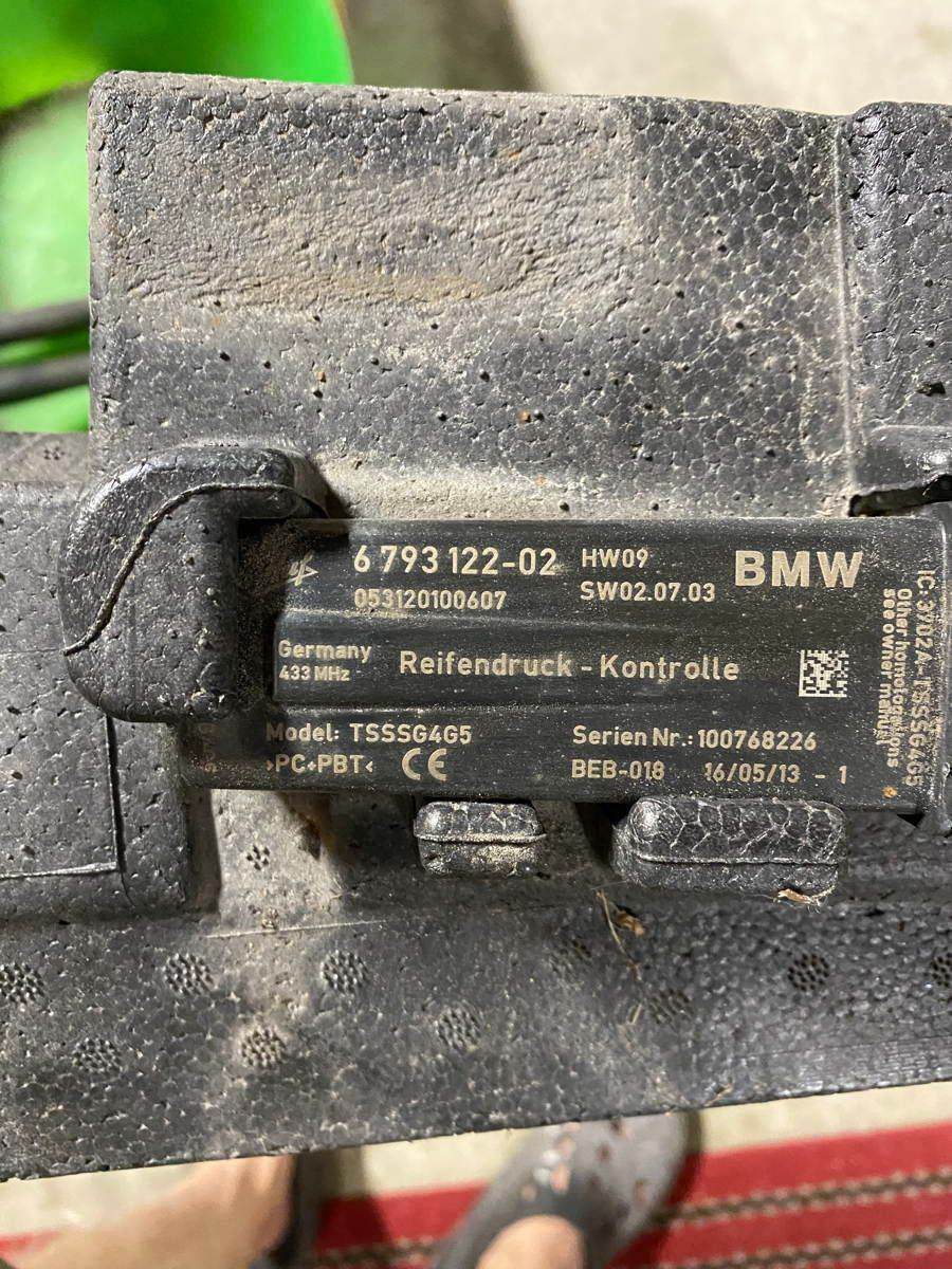

Be mindful of the Tire Pressure Monitoring-Control Module, MINI part #6793122-02; enough of the foam shock absorber material needs to remain to hold the module in its stowage location:
TPM Module in its slot in the foam shock absorber
Once the reinforcement member is scrapped and the foam shock absorber is trimmed in half, the Curt hitch is installed over the existing bolt holes. eTrailer's hitch package provides replacement bolts and washers. Getting the hitch lined up with the existing holes took some muscle, along with a fine touch as the fit clearance is very tight:

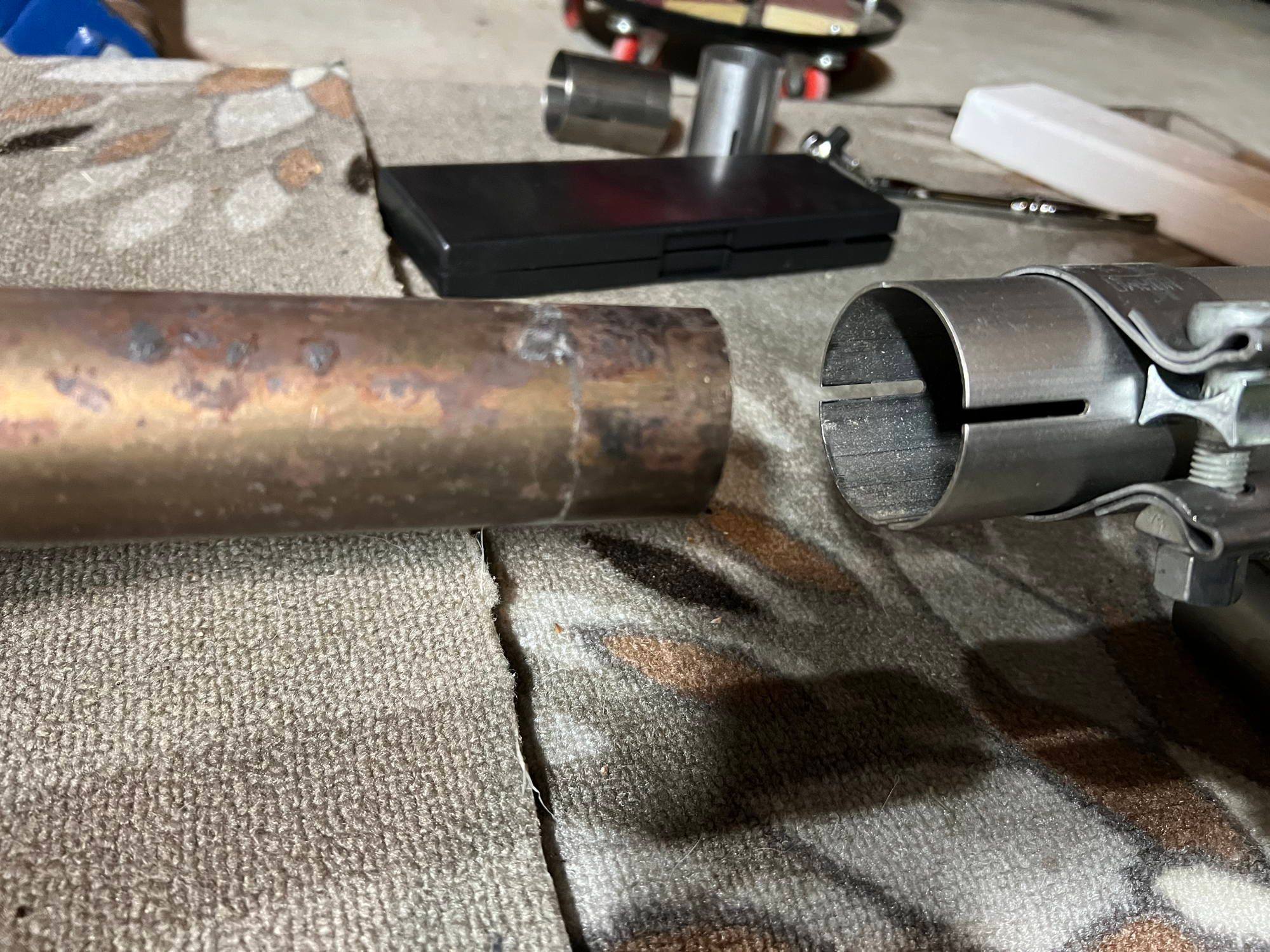

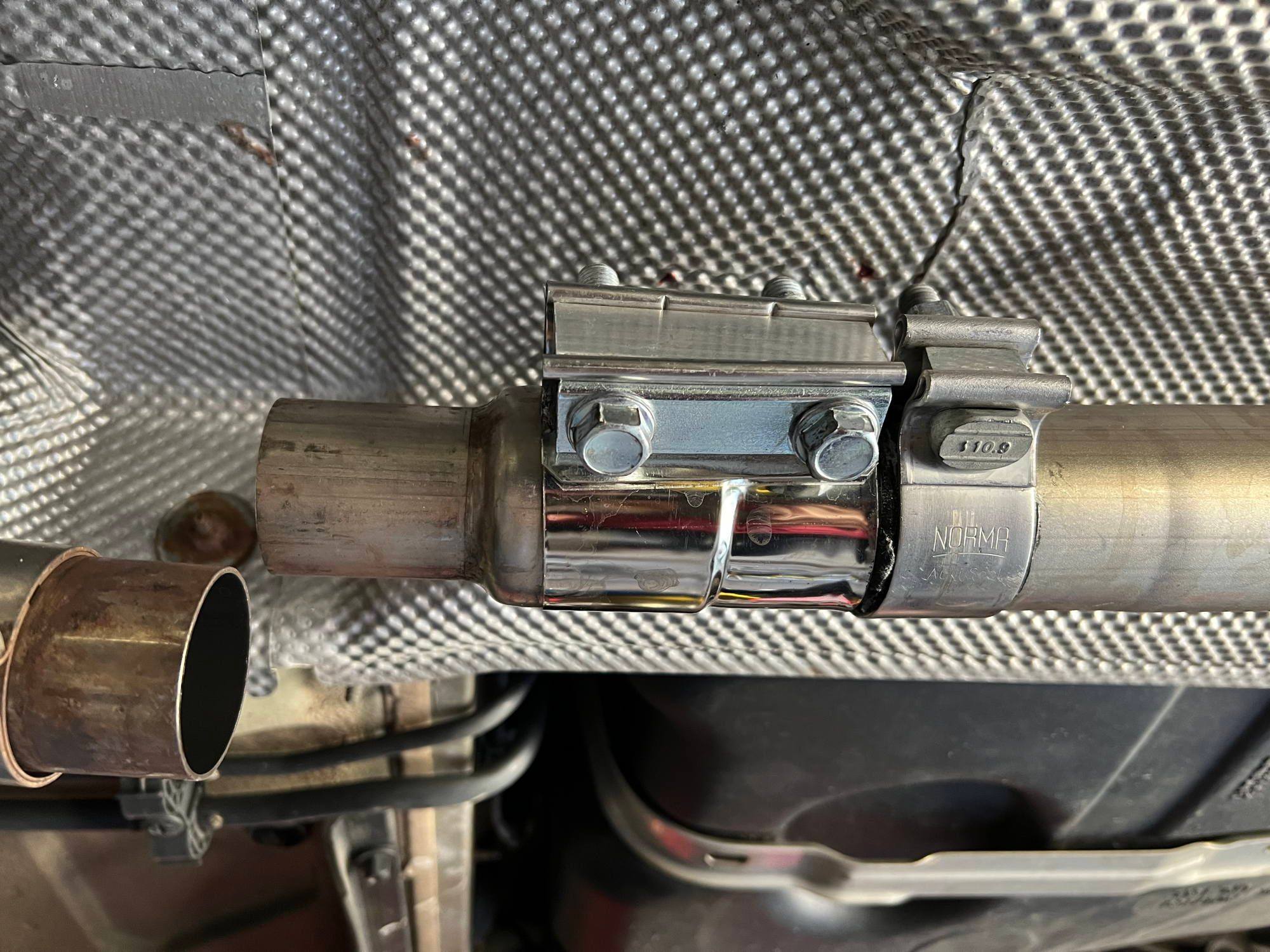

I then needed to craft an adapter to connect the 1.5" ID (40mm) OEM exhaust pipe to the larger 2" ID (50mm) exhaust pipe; the adapter assembly had to both fit the two pipe IDs, while also being long enough to bridge the 5.5" gap in the two pipes in their fitted-up positions. This was tricky - I'm not yet satisfied with how this is put together - too many parts that are clamped, not welded. I'm going to have a proper adapter welded to the REMUS exhaust pipe, but keep the butt connection to allow for easy removal of the exhaust if that ever becomes necessary.
1.5" ID OEM exhaust pipe to 2" ID REMUS exhaust pipe
2.0" ID to 1.5" ID Lap Joint Band Clamp to 1.5" ID to 2" ID Adapter Reducer to 1.5" ID Butt Joint Band Clamp
Assembled connection. Not elegant.

Always been a fan of Remus exhaust but yeah they're more work to find. They sound healthy without being obnoxious.
Heh - as best as I can tell, the only way to "find" this model of the Remus exhaust for the normally-aspirated MINI Coupe was to have Remus make it to order in Austria, and then have it shipped overseas to the states. ECS managed that process for me.
I did get rid of the clumsy reducer clamps and have that Remus 2" pipe to 1½" reducer to OEM pipe properly welded together, keeping the butt connection intact to allow for easy removal if that ever becomes necessary.
Welded reducer in situ
So now I have a nice OEM axle-back exhaust assembly for sale. I'll post something about that later.
