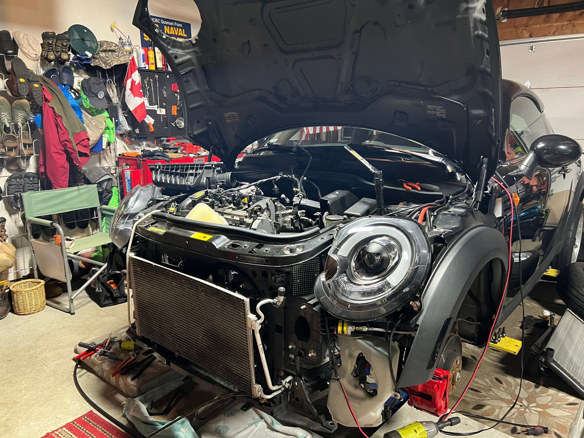

While changing my oil and putting on my summer tires, I noticed coolant coming from the lower hose area on the radiator. After pulling the lower hose off the connector, it looks like I've a small crack on the radiator side of the hose connection. So after ordering new parts (radiator, hose, misc. gear) I'm in the process of removing/disconnecting everything that is in the way. The BMW/MINI repair guide is a big help - https://bmwrepairguide.com/
While I'm in there I'll replace the thermostat as well:
More after I get this done. Now just waiting for the parts to arrive.

Continuing from above:
Time to document this year's spring project. This thread is NOT a step-by-step process on how to do this work, the following is only provided as general information of what I accomplished, with some photos.
As I mentioned earlier, I originally set out to do just an oil change and swap in the summer tires. But in the process of removing the skid plate and draining the pan, I noticed an antifreeze leak at the bottom of the radiator by the lower hose outlet.
Antifreeze under radiator, near outlet
Time to investigate. Unclamped the radiator hose, drained the coolant, but I didn't see anything obvious. The hose itself, while original, still looked good. The only thing left was to order a new radiator and lower hose; regardless of what I found those two new parts would certainly fix whatever was leaking from that area. Removing the radiator required removing the front wheels, both fender liners, the grill, and bumper.
New radiator installed
Installing the new radiator was a cinch once the space was open, but then as I was looking at all that room I thought I might as well change out the thermostat. That changed the simple repair into a much bigger project.

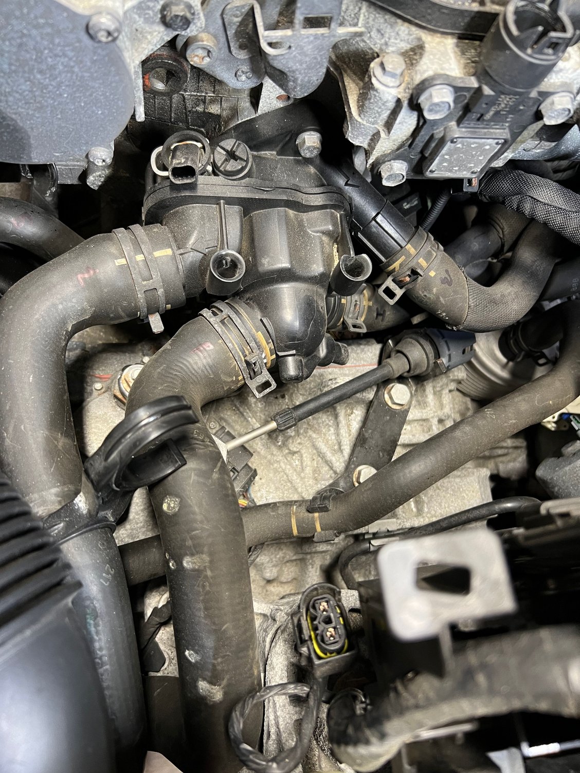

Ordered the new thermostat, and while checking out what was required to install the part I started reading about what else would be required to complete that process. Then I learned about the infamous crossover water pipe that connected the water pump to the thermostat. I discovered that this relatively flimsy pipe had a reputation for falling apart while disconnecting the thermostat. So I decided to order a new crossover water pipe. Many have commented at length about this stupid design and flimsy plastic pipe, but also about how much of a pain it was to install the pipe and thermostat without having to disassemble the back side of the engine. So I decided that the smart move here would be to install the new crossover pipe after removing the intake manifold, opening up that space so as to have a clear view of work space.
OEM plastic crossover water pipe in its installed location, disconnected from the thermostat housing. Water pump location on the right side of the pipe.
Removing the intake manifold would also require new gaskets for the manifold, the throttle body, and o-rings for each fuel injector. But then heck, I might as well replace the fuel injectors while I had them out anyway. Doing all that work also required disconnecting the wire harness connecting the two VANOS modules, the oil pressure sensor, coolant temp sensor, each ignition coil, each fuel injector, and a collection of other sensors and connectors around the engine. Pulling the fuel injectors out was not easy, took some patient pulling and gentle leverage to get them to pop out. As I was going to put in new injectors I was not too worried about damaging the injectors and the o-rings, but I was very careful about not stressing or cracking the fuel rail that comes out with all the injectors still attached. Another strange design.
Intake manifold, the open port in the lower left of the manifold connects to the semi-rigid PCV vent hose.
The hardest part about removing the intake manifold was dealing with the PCV hose connecting the top of the valve cover to the vent connector underneath the manifold. This hose looks like a flexible hose, but it isn't, and it shattered as I was trying to manipulate it away to gain access to the outermost manifold bolt. So I ordered a new PCV hose. I experimented with substituting a 19 mm (¾") fuel-tolerant Gates hose to the original connectors, but the bends were too tight and the ID of the hose would crimp closed. Coming up with an aftermarket substitute for this appalling design would be a business opportunity for someone with an enterprising bent (pun intended):
PCV "Breather Hose" connectors needed. Note the oily residue inside the lower hose connector (top) with its sensor connector.
The bottom connector goes to the PCV valve in the valve cover.
I read that the PCV valve is integral to the plastic valve cover - MINI calls it a "non user-serviceable part" and replacing it properly requires replacing the entire valve cover. Yet another stupid engineering decision, common to both MINI and Peugeot/Citroën that share the same "Prince" engine type. But in for a penny, in for a pound - I shopped around and saw that ECS sells an aluminum valve cover, pricy but certainly more desirable (to me, anyway) than the plastic valve cover. And it was painted red, that certainly would look good in my MINI's engine bay, I thought. And it came with a new gasket as well.
Back to the intake manifold - after discovering the hidden sixth bolt underneath the manifold and then disconnecting another vent hose and several wire harness clips, I was able to completely remove the intake manifold.
Intake manifold, replacing the gaskets. Lots of oil residue in the manifold.
What was revealed then was a revelation. First, the plastic crossover water pipe was now easily removed from both the thermostat and the water pump. The pipe survived the removal intact - I could likely have gotten away with simply reinstalling the old crossover pipe to the new thermostat housing, but I would have needed to replace to distorted o-rings at either end. Now I understood the thinking behind how that pipe maintained watertight integrity; when the thermostat housing is fully seated and bolted in, it compresses the male connector end of the water pipe into the female recess of the thermostat housing. That is all that holds that pipe in place, no bolts on either connection. But I was much more convinced of the strength of this connection when I replaced the plastic pipe with the metal water pipe (also from ECS). It felt strong enough to where it could likely be used to lift the entire engine.
OEM Crossover Water Pipe removed. Water pump outlet on the right, starter motor at bottom center. The bracket sticking out from the engine block and just left of the
water pump impeller outlet is where the mystery bolt on the bottom of the intake manifold connects.
New metal water pipe installed, a very high quality pipe, nicely finished, that nobody will ever see, unfortunately.
Thermostat housing connection point to the pipe is on the left, water pump connection point on the right.
