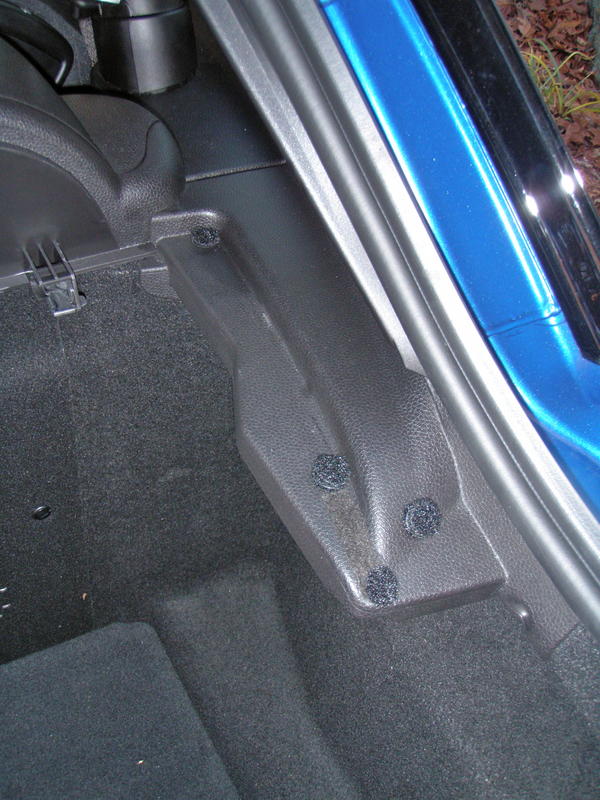

Any photos of where the padded dots should be stuck?

The photo shows the right side of the boot. The dot stack on the outside is for the back cover. It's five dots thick. The other dot stacks support the front cover....the top two are 3 dots thick and the bottom one is 1 dot thick. You may be able to get away without front cover supports, but this is how I did it since with only the back cover supports there was still a slight rattle. Same set up on each side.
