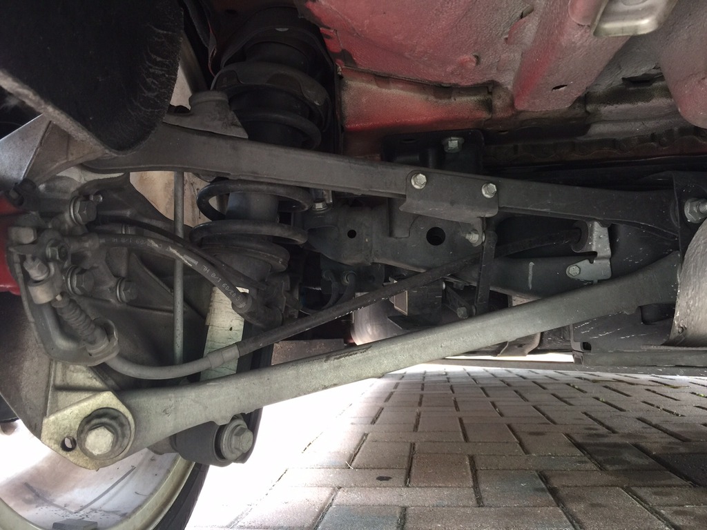

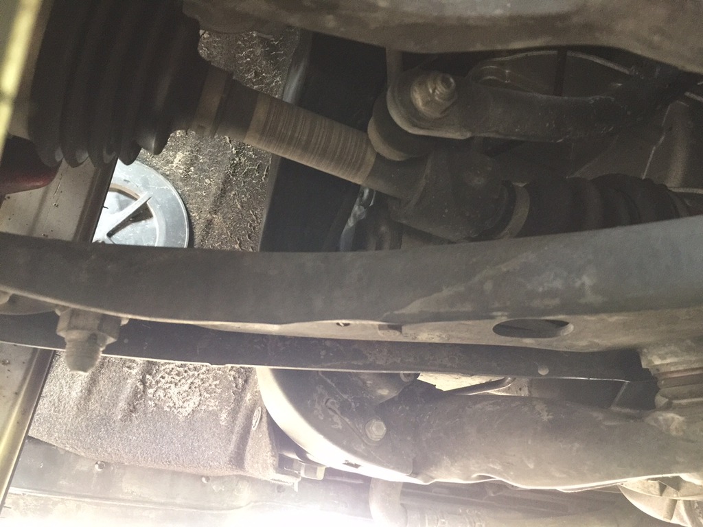

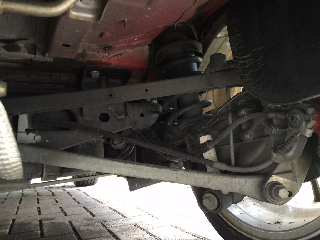

Old May 28, 2015 | 12:02 PM
davemt74's Avatar
davemt74
Joined: May 2015
Posts: 12
Look at the struts and springs or take a pic.
tried to duck under the back of the car to take a few pics. This is call I can manage for now with such a small space.

Old May 28, 2015 | 12:06 PM
Posts: 36,762
Likes: 2,551
Yea, its not a JCW Tuning suspension , its stock and not on lowering springs. Those little white stickers look faded, get a pic close to those sticker on the strut and that will tel you more. '
Thanks for the pics.
