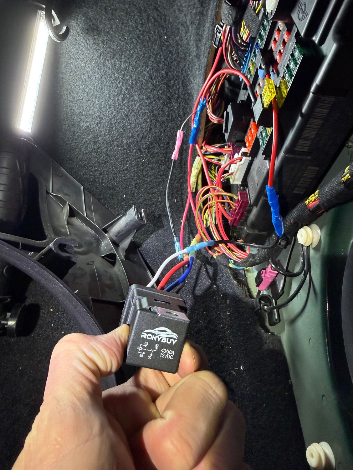

I installed the relay as shown but still cranking with no start. I don’t seem to be getting power at the fuel pump. Any ideas?

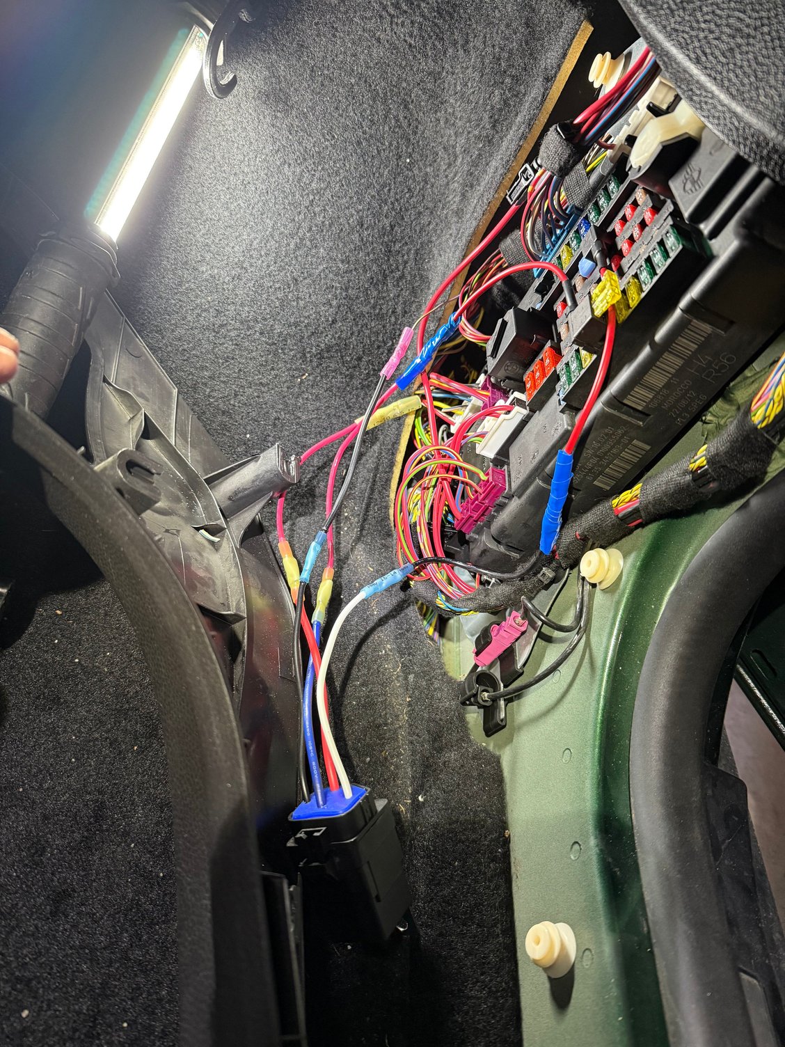

Let's start with your bypass relay wiring, which is difficult to verify in your pictures.
The fuel pump side of the bypass relay must receive battery voltage from fuse 46 and output the latter voltage to the white/blue wire at pin 9 of white connector X11010.
The switch side of the bypass relay requires a 12V source and a ground source to allow voltage to pass from fuse 46 to the white/blue fuel pump wire. I know you are looking for a proper 12V source, but what are you using for the ground source?
Another question is whether you have verified that the shop's JBE diagnosis is correct.

I am using violet/green wire, pin 17 from the connector right above the white connector as the ground. On the relay it connects to the black wire, not sure what pin that is. The white wire on the relay goes to F15 and I tried F6 too, thinking maybe the problem was the 12v source.
completing the relay is blue wire to F46 and red wire to the blue/white wire going to the pump. I had to cut the blue/ white from the white connector but I left enough to splice.

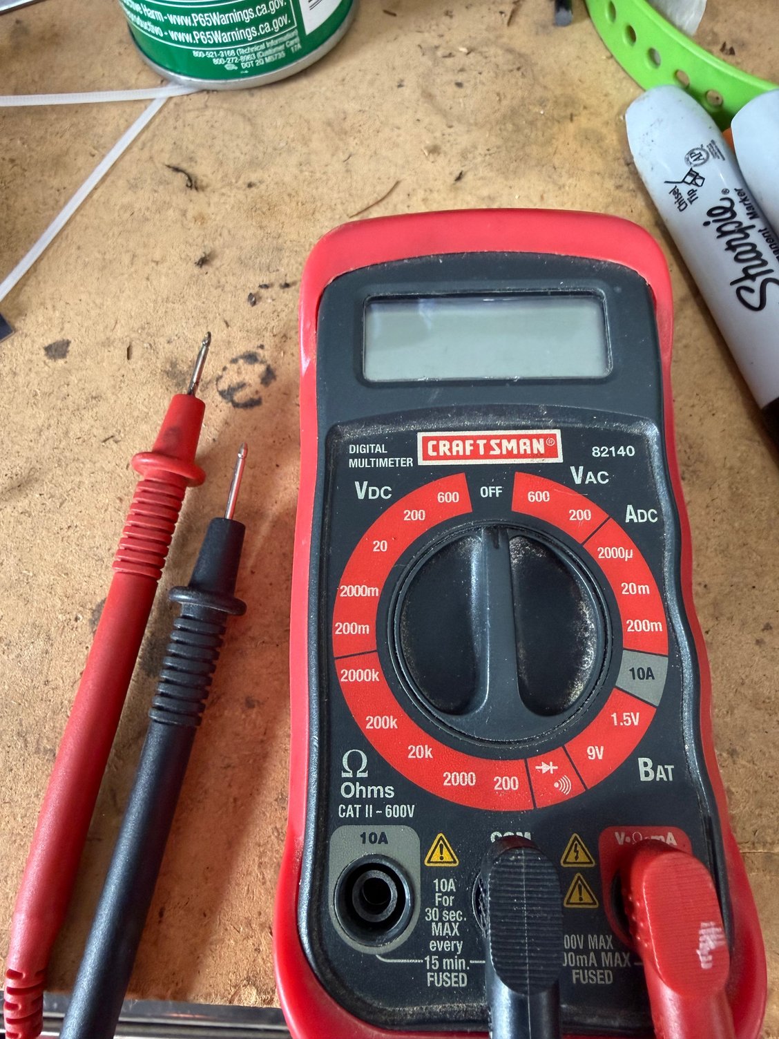

And I can tell you how to measure voltage and ground with your multimeter for the different wires, if you post a picture of your multimeter.

Do you have a normally-open or normally closed relay? It should be a normally-open relay.
Is this how you wired the bypass relay?
12AWG wires
Pin 87 Blue (Output N/O) -> white/blue wire to fuel pump
Pin 30 Red (VDC) -> 12V from from F46
16AWG wires
Pin 85 Black (Ground) -> violet/green wire to DME ground
Pin 86 White (Trigger) -> ignition switch-controlled 12V source

No, I have pin 87 and 30 reversed from what you wrote. It is a normally open relay. I’m hoping you found my mistake. I’ll correct it this afternoon and report back

I’ll post it later today. Thanks. If I’m going to keep this Mini I need to learn how to troubleshoot a lt better

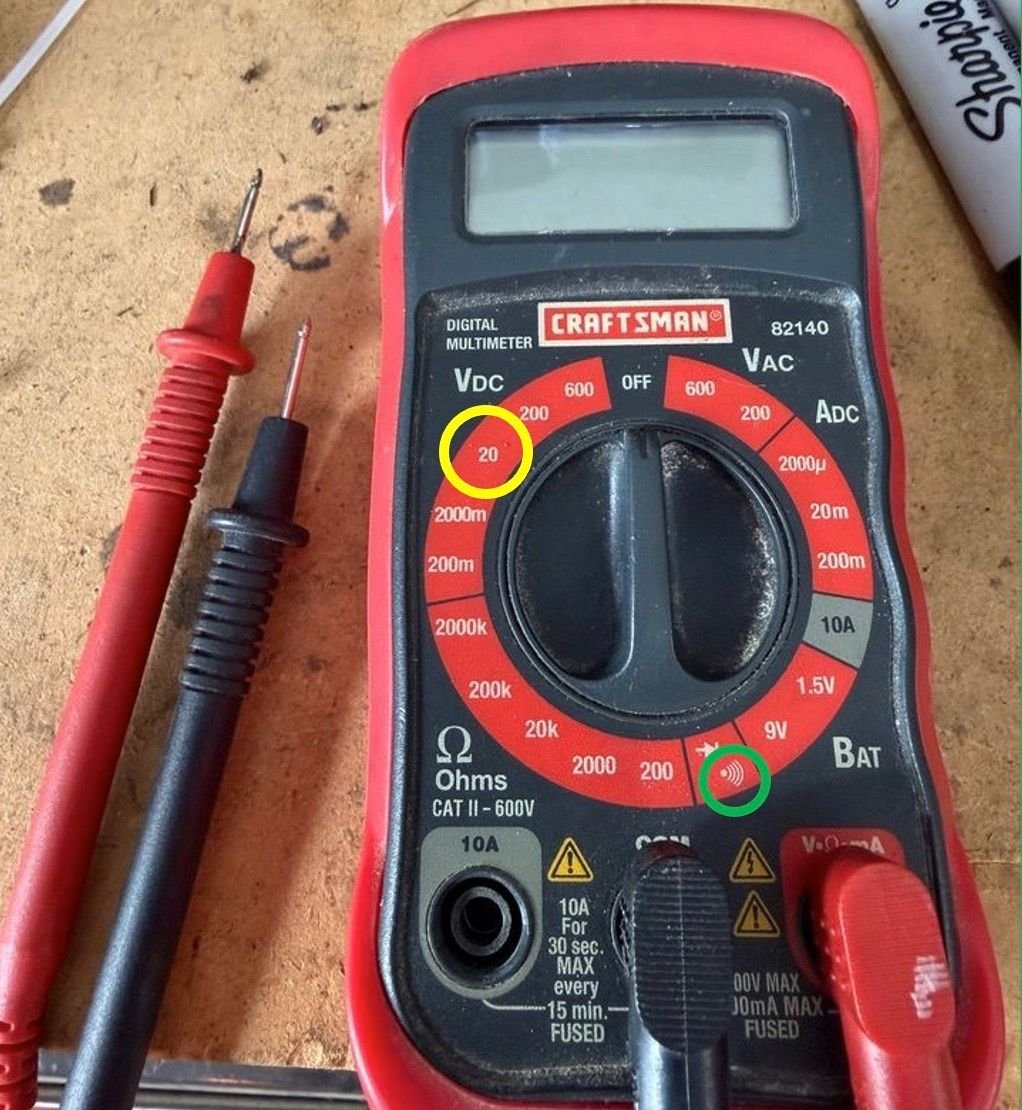

Your leads are installed correctly. Use the 20VDC setting for your voltage measurements and the audible continuity setting to test grounds and relay activation.
