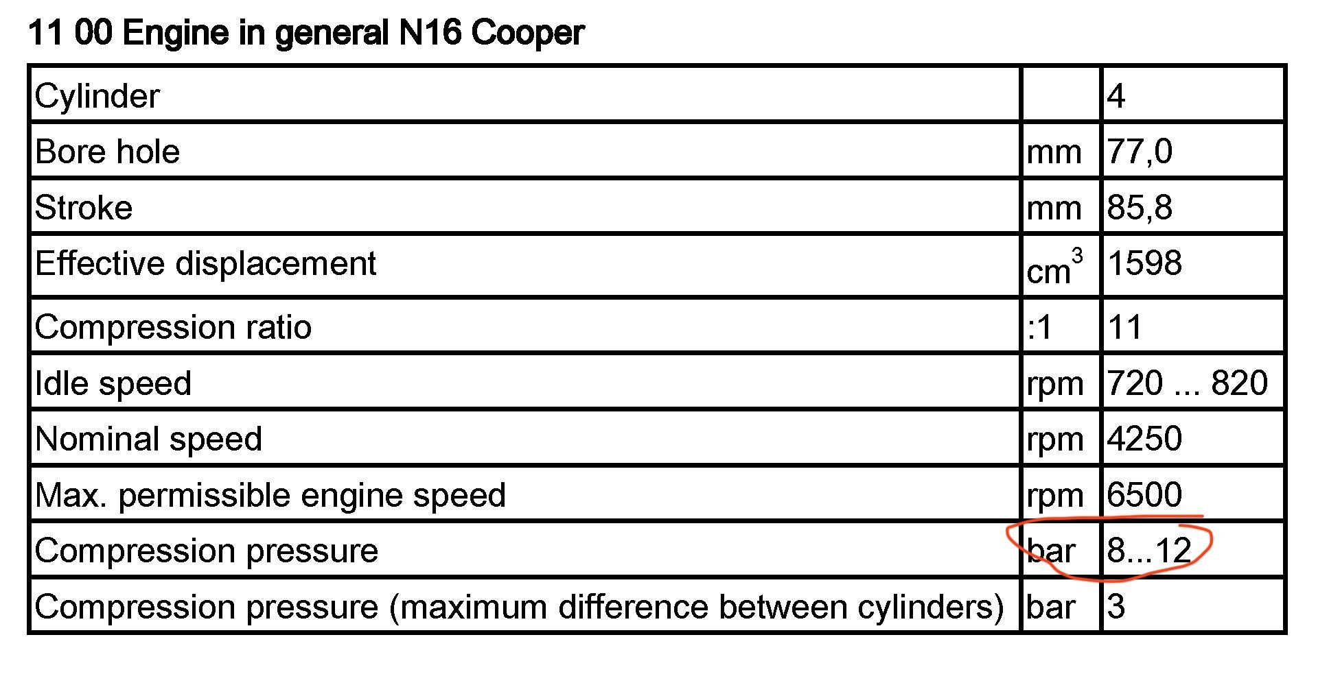

According to AllData anywhere from 8bar-12bar(116psi-174psi) is considered good as shown in the image below.

The minimal increase in cylinder compression of the warm engine versus the cold engine is a concern.
And I would expect at least 180 PSI for a warm rebuilt engine.
Maybe others have different opinions.
