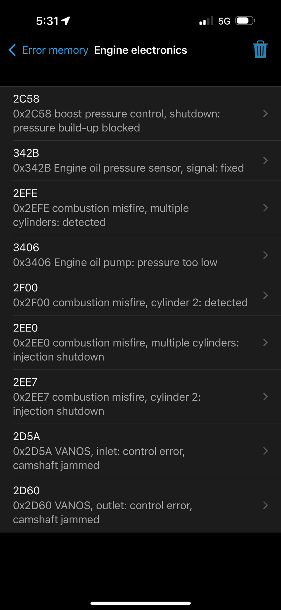

My MINI won’t start and I’m getting engine oil pump / oil pressure errors, camshaft jammed error, boost pressure control errors, misfires, it’s all messed up.

EDIT: You first say the mini won't start, later you said it started right up. Is it running fine, you just can't get the codes to clear??
EDIT: The rest below was my original post:
2C58 is caused by other codes, don't worry about that one yet. It pertains to letting the turbo build boost which it doesn't need yet.
4 codes related to misfiring. Unclear if these were set when you had the coil packs unplugged.
Camshaft jammed errors. Frequently, these kinds of errors indicate VANOS actuator failure. Common problem, and easy to fix. But it does seem odd for them to fail right at this moment and cause such a big problem. The low oil pressure fault could be related to these errors, possibly even causing these VANOS errors. Low oil pressure is very very bad for these engines (though usually it happens because of low oil which is the real problem). Getting to ok oil pressure might be step 1 if the timing job isn't wrong.
Coil packs are ALWAYS suspect when a misfire occurs.
And of course at this point it is possible you did something wrong on the timing job. Easy enough to pull the valve cover and see how the shafts and their flats line up, crank lock pin goes in, cam lock tools fit nicely, etc.
The camshaft position sensors are bolted into the valve cover/pcv, one for intake and one for exhaust. They are both on the drivers side of the car, assuming a north american left hand drive configuration. I don't think you could've hurt these while wrestling with the oil filter cap. Again assuming left hand drive config, the VANOS solenoids are on the passenger side of the engine, opposite the oil filter. So unclear what you mean by "..so I want to make sure I didn't bump the oil pressure solenoid thing." when referencing the oil filter.
I'm more familiar with the n18 engine but I think locations I've stated are correct for you as well, sorry if not. I just try to help (note that some kinds of help are the kinds we can all do withOUT)

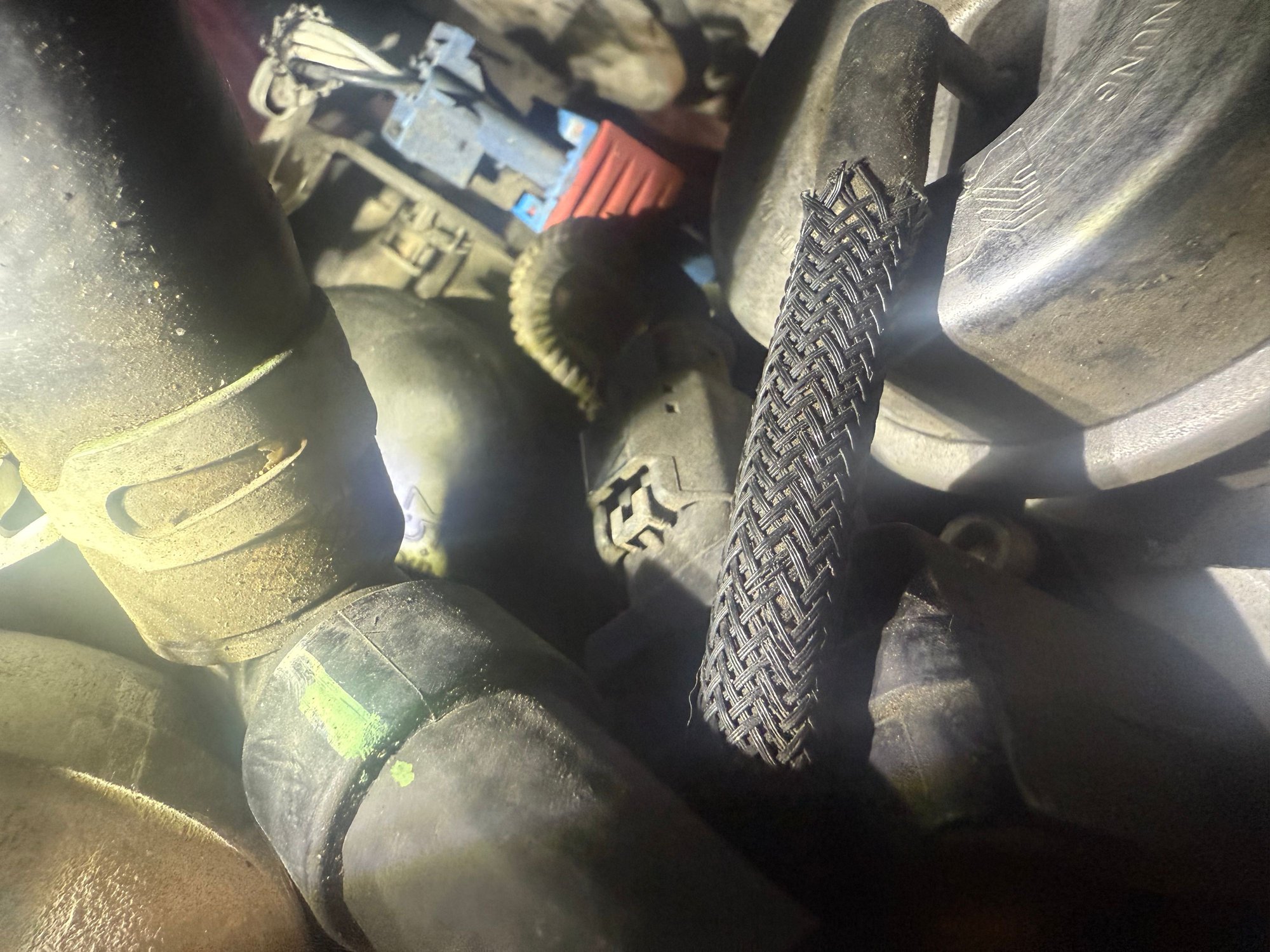

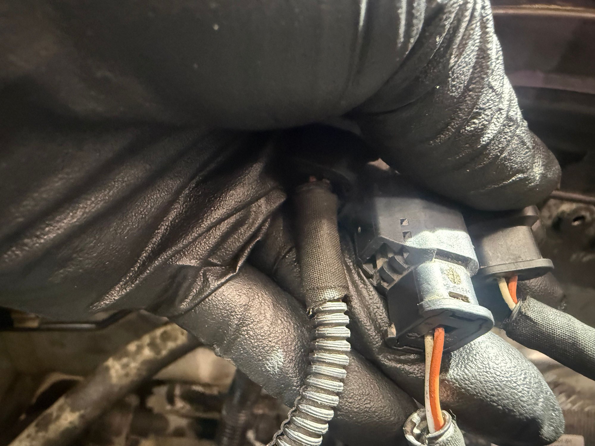

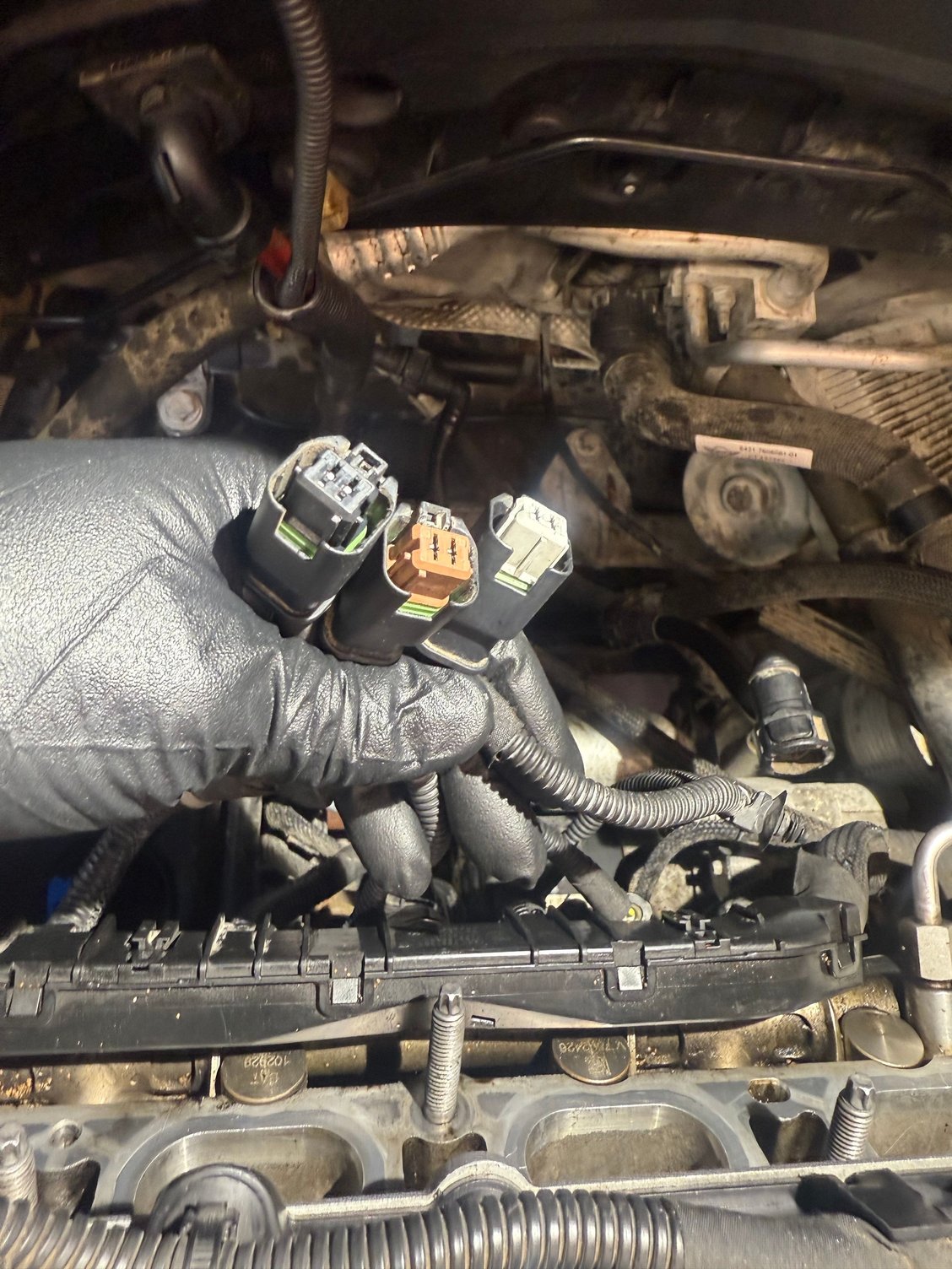

N18, ok. Don't know why I guessed N14, sorry. Does the car run, and if so with any symptoms beyond codes?
Your first picture with the three connectors near the fuel rail / intake box. No way you can mix those up with the wrong sensor, different form factors and very differently keyed just from looking at them. Sorry, don't remember which goes where.
Your next picture looks like what might be exhaust camshaft position sensor, but not sure the harness for that would come up this far. I know there are a couple of very similar connectors in that general corner of the engine, the vacuum pump corner. Sorry, again I don't have a diagram/pictures.
There is a sensor near the top of the oil heat exchanger/oil filter housing. It's connector points straight out from the block towards the front bumper. Not 100% certain but I think this is the oil pressure sensor. I mention this sensor because it looks like the kind of connector in the second image, the kind of connector in that corner that visually could get mixed up (unsure if protectively keyed). If it is the oil pressure sensor, and I think it is, maybe at least 2 connectors are mixed up and that's why you're getting an oil pressure error code.

I just checked and the oil pressure sensor plug was unaffected and looks to be fine. I do think that I pressed against it when I changed the oil filter but probably not enough to affect it.

The blue plug in the distance I'm not sure about, but definitely not attached to the oil pressure sensor (or the sensor I meant). The other black connector appears to be the DV valve (diverter valve) on the turbo body, from its position relative to the wastegate actuator and body of the sensor.

Code 342B suggests that the DME is not receiving the oil pressure sensor signal.

Or, he is getting an oil pressure signal and a broken piece of the timing chain guide is stuck in the oil pump inlet, starving the engine of oil pressure.
What year is the car? If it's an LCI, you can see engine oil pressure with your scan tool under live data. Lack of oil pressure will also cause issues with the VANOS since it needs oil pressure to operate.

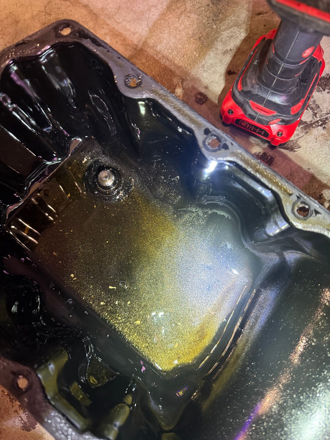

Ding! Ding! Ding! Winner winner chicken dinner!
****. I dropped the pan and saw some shimmering fairy dust in the bottom… almost magical. My suspicion proved to be right, the chain was off the sprocket down on the oil pump… so that’s not gonna pump anything. Also, bonus huge piece of plastic caught in the oil pump chain sprocket housing. Now I need to figure out how to get the chain back on this sprocket without screwing up anything else. Any suggestions? How can I remove this sprocket is it safe to put a few screwdriver’s through it to keep it still?

Yikes. Well, glad you checked it now rather than later.
I personally don't know if it is safe to run a screwdriver through those holes to brace it while loosening the bolt. But, it's exactly what I did when I was in there.

Yikes is right! That could have been catastrophic. Not what I would have guessed given what you said earlier about re-seating the sprocket. My next suggestion was going to be to check the oil pressure solenoid connection that goes to the oil pump, it was a known to leak on early N18s and was a warranty job on my previous car. Glad you found that!
