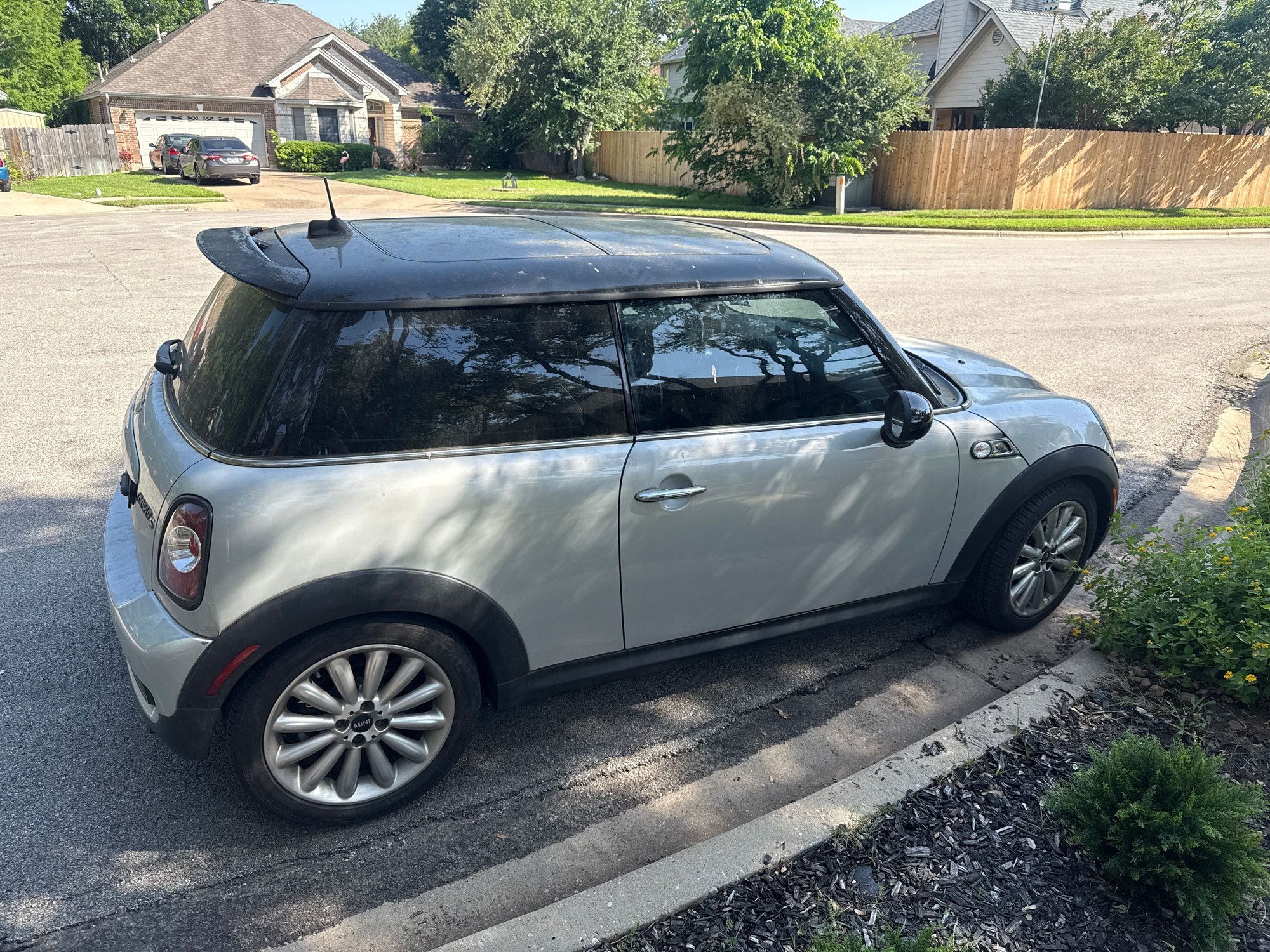

I poured the oil over the valves and primed the engine with cool packs unplugged... I forgot to unplug the fuel pump relay. I realized this on the third 10 second priming sequence. I knew I already had oil mixing with gas... So I connected the coil pack plugs and tried to start her up. Ittook three tries because it was sputtering out the first two times. On the third time it was sputtering and I gas her some gas and... Vroom. She's running like a Swiss (well, German) watch. She's idling quiter, and the death rattle is gone. I'm not hearing any mini rattle from the slack on the oil pump chain either. I cleared the errors and the adaptations and I think it's good to go. I took her on a short drive and it drivng smooth. Going to stretch her legs later today.
Thank you all for you advice and support. I learned a ton about my car, and I have a lot more confidence in my ability to turn a wrench. I also really really appreciate this community. I hope I can pass it in to other R56 owners soon.
