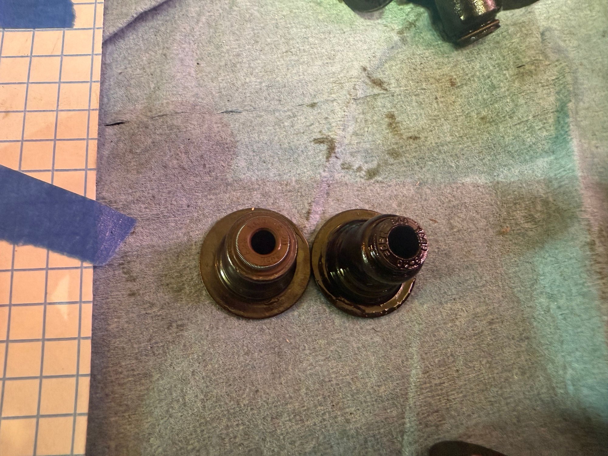

I just finished this journey this week. My blue smoke issue started with something unrelated, I was trying to refill the refrigerant, which takes a LONG time sitting there idling. My 2011 MCS N18 has never sat still so long and it was starting to drown in oil. After a few minutes of doing so, I would give it some gas and a huge plume of blue smoke would blast out. After that, I tested the coolant for any exhaust, luckily there was none, but this confirmed that I had to do the valve seals. Also, since you are going to be in there and going to need to take off your cams, you’ll probably going to want to go ahead and do the timing chain (it’s really more the plastic chain guides that are the problem). It WILL fail. Luckily I only had to fish out large pieces of plastic. Unfortunately this is likely mandatory service for your car in the next year or two.
Do your valve seals. It’s time. I let it idling for 30-40 minutes, again trying to refill the refrigerant, and not a puff of smoke. You know it’s time. For clarity, here is what’s going on in your engine.
New on the left, 93K miles on the right. Please also note that I drive like a wuss most days. Obviously, the one on the right ain’t gonna be snug around the valve stem, so oil is going to just pour right down the stems.
