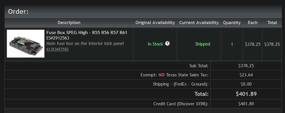

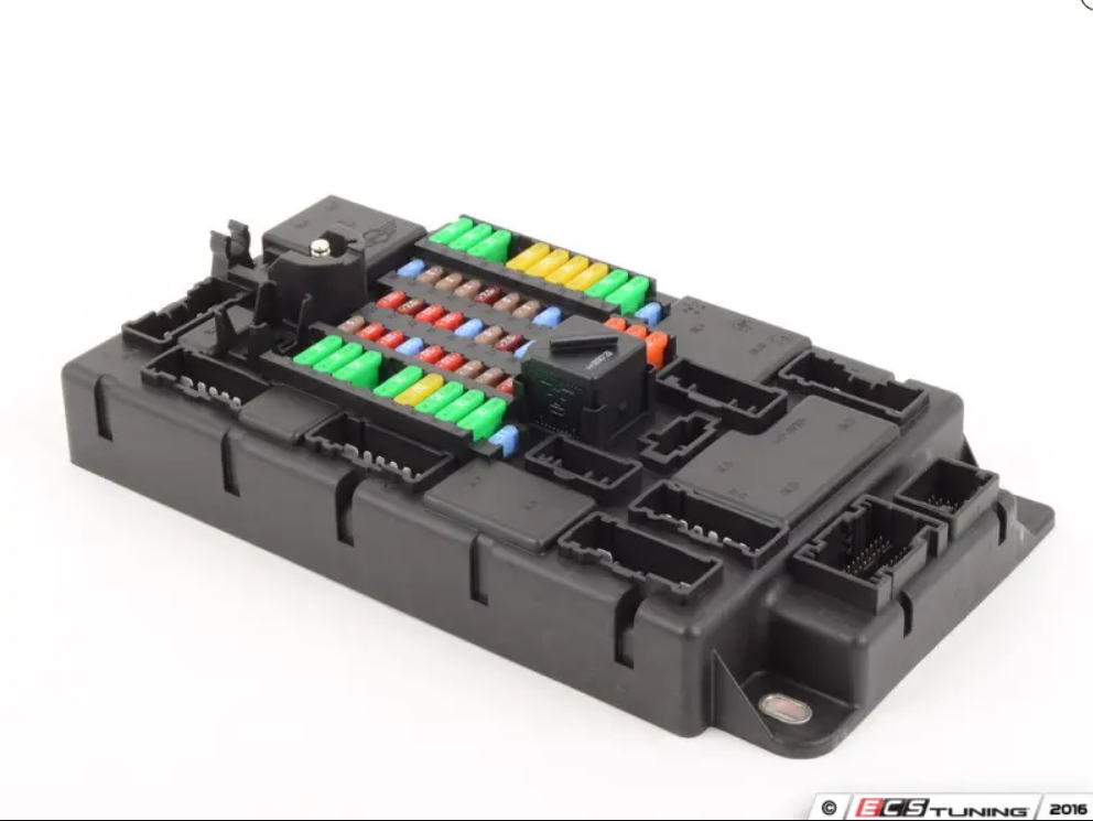

same issue with my 2011 N18, had to swap the Fuse Box SPEG (corrosion on relay pins to fuel pump power)
https://www.ecstuning.com/b-genuine-mini-parts/fuse-box-speg-high/61353457582/

mine had no sign of corrosion (or water intrusion) just shitty soldering that I could not fix myself.
also --- when I bought it in 2022 the price was exactly half of that.... $378, so that price may be wrong on ECS.
