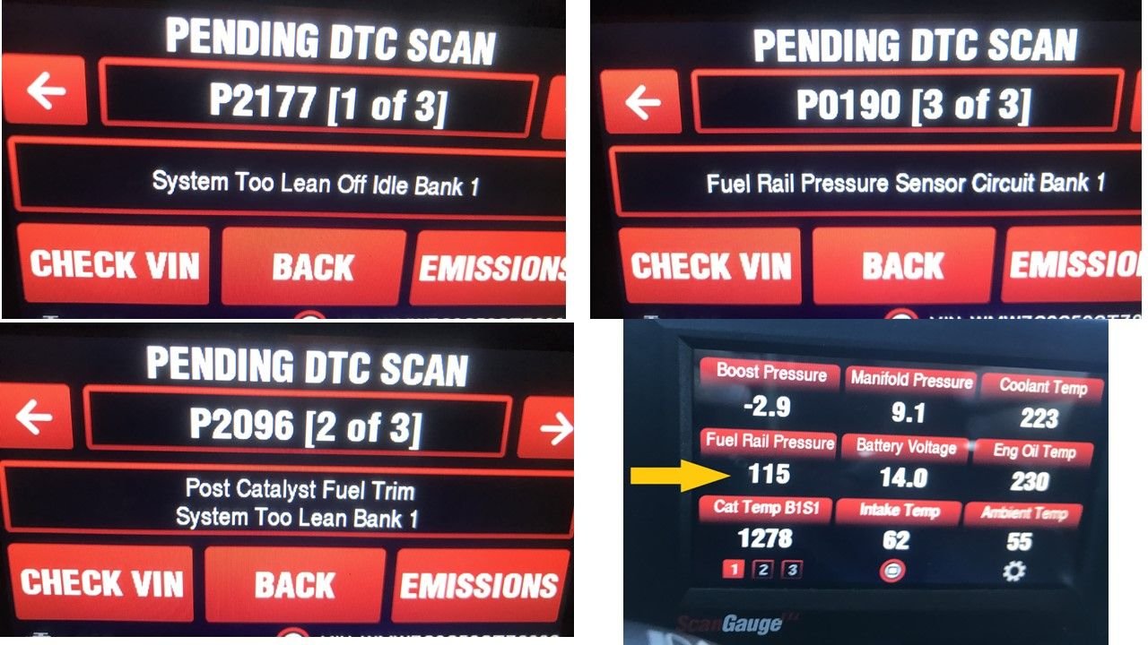

Over the past month or 1,000 miles, a few times, and randomly, I have noticed that the car was "bucking", very low on power, no boost, and Fuel Rail Pressure dropped to ~120-150. But it never set CEL, only one "Pending" code P2171 "System to Lean Off Idle Bank 1". So, I removed the Mass Air Filter sensor and cleaned it, as well as the First O2 sensor which looked OK to me.
The problem would go away, but intermittently would come back.
Today I had to drive to the airport which is a 70mi drive and it finally set the CEL and now I have 3 "pending" codes: P2177/P2096/P0190
Before I start changing parts, can I get some input here please? I have heard about the HPFP needing to be replaced. Could that cause this?
Photos attached and you can see the displayed Fuel Rail Pressure drops when this happens, but I am not sure if that is the cause or if that is the effect!

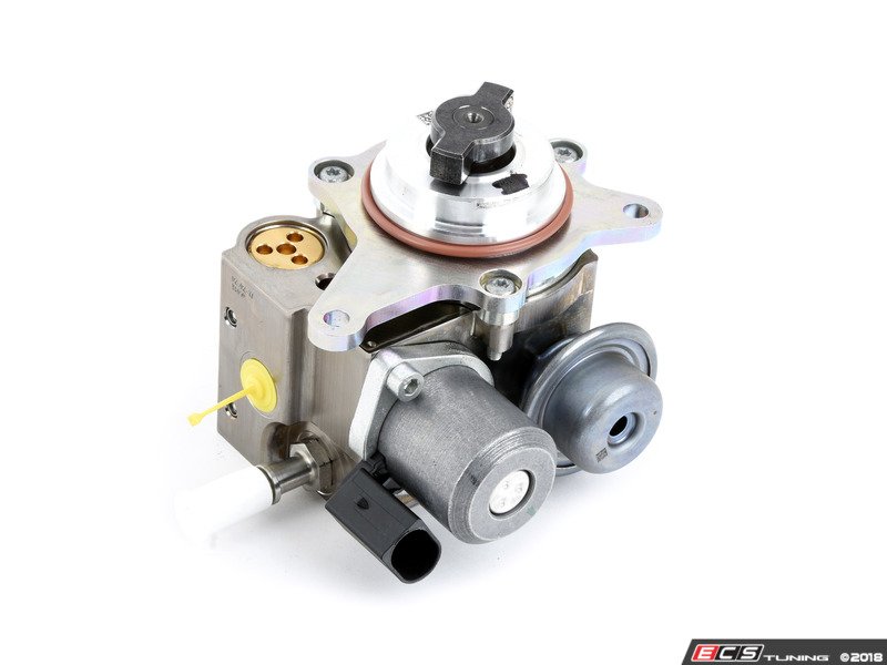

Just saw this. Yes looks like HPFP based off those codes. You will get a cold start stumbling daily then it fails all together.
https://www.ecstuning.com/Mini-2012-...C/Engine/Fuel/

From the pictures you've posted, you have two O2 sensors telling you the engine is running lean. You also have a code indicating a problem with the fuel rail pressure sensor, so the fuel rail pressure of 115 is suspect and not to be trusted. No offense, but pulling an O2 sensor and looking at it won't tell you if it's functioning properly. However, with your scan tool you can pull up the STFT & LTFT and inject propane in the intake. Both sensors should go full rich. Now remember the upstream sensor is a wideband and the downstream sensor is a narrow band. Meaning, when you inject the propane you'll be looking at the upstream sensors current do drop (rich condition) and the downstream sensors voltage to rise (rich condition). If your scan tool has an OBDII menu, use it instead of the MINI menu.
The first step would be to read up on the engine fuel system theory of operation as many components can cause a lean fuel trim condition. What I would want to know is the fuel pressure sensor downstream of the HPFP or upstream. Meaning, which fuel pressure discharge pressure are you reading ... the pump in the tank or the one on the cylinder head? I'd also want to know where all the fuel pressure relief valves live; from the picture of the pump posted by ECS, it looks like the relief valve is on the HPFP.
Next, use your scan tool to pull up short term fuel trim (STFT) and long term fuel trim (LTFT). Paul's book has a great section on how to use these numbers for diagnostic purposes. Write down your fuel trim numbers at idle, 1500 RPM, and 3000 RPM. I understand you have 35 years of experience, but how much formal schooling to you have? Heck, I have an A&P license and worked on fighter aircraft for 26 years in the Air Force, and I still learned a lot from Paul's course. (Scannerdanner.com)
