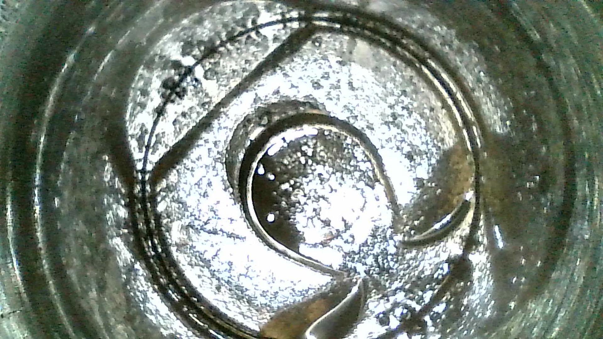

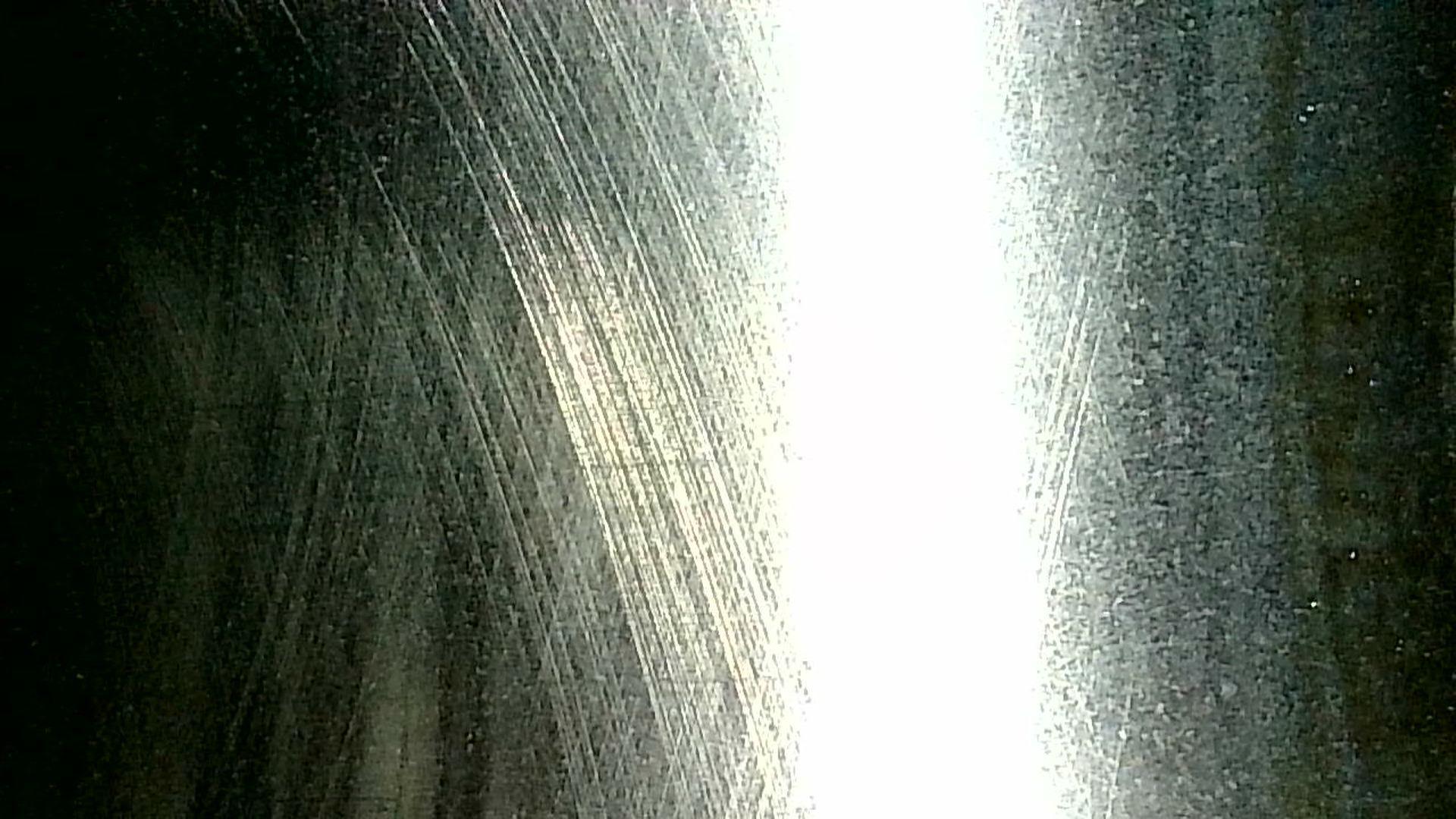

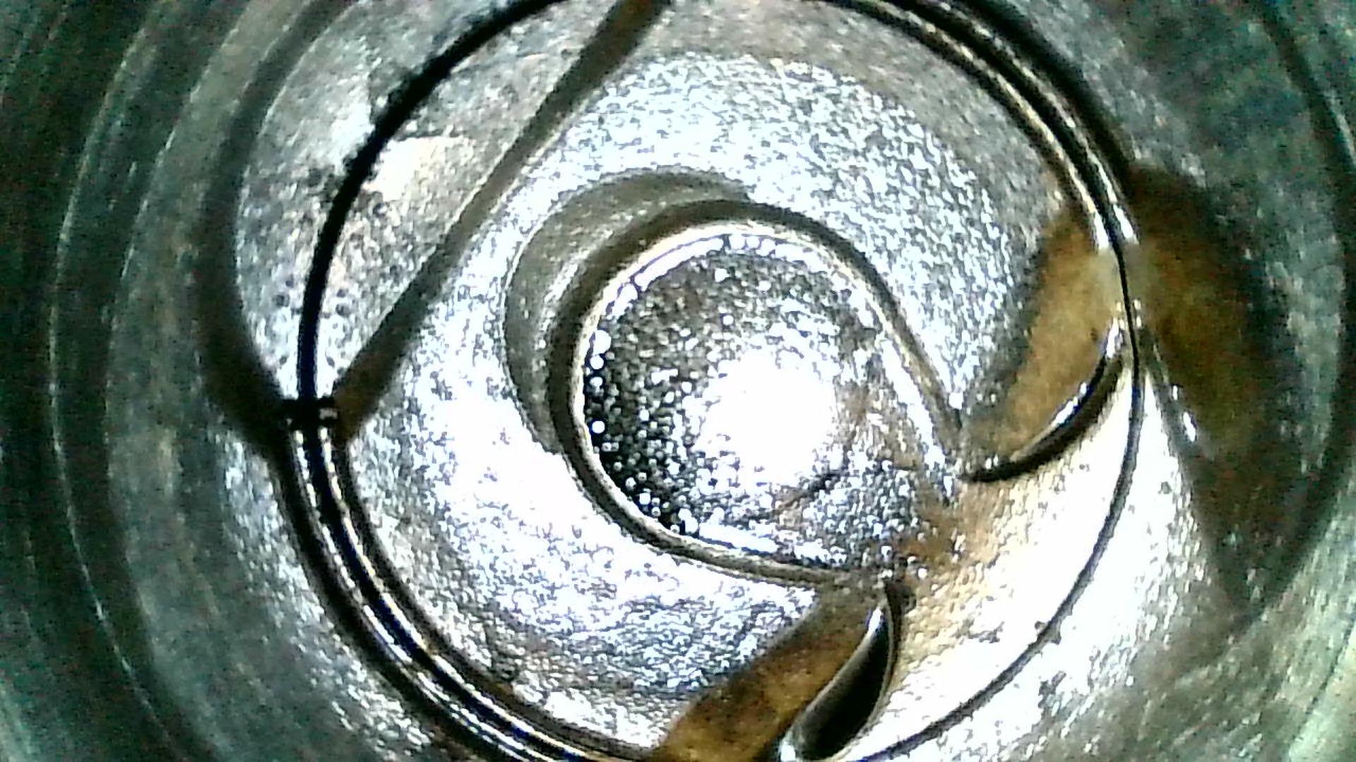

Hi everyone,
I am having an issue or issues with my 2010 cooper S. I pulled the spark plugs and sent a borescope into each one to find heavily oiled cylinders. I also did a compression test and got 150,160,160,160 starting from the driver's side to the passenger side with the engine warm. I have attached pictures here and a link to youtube video with the exhaust smoke coming out of my mini. I am just trying to figure out where is the oil coming from? Is it my piston rings or could it be valve seal related? Would definitely appreciate some input on this issue.
Link to video:
Pictures of the pistons and cylinders below:

^Either or both is possible. What are the differences between the dry and wet cylinder compression numbers? Can I assume that you disabled the fuel injectors during the compression tests?
Also check whether the PCV & breather systems are working properly. High crankcase pressure due to a lack of crankcase venting could contribute to oil burning.

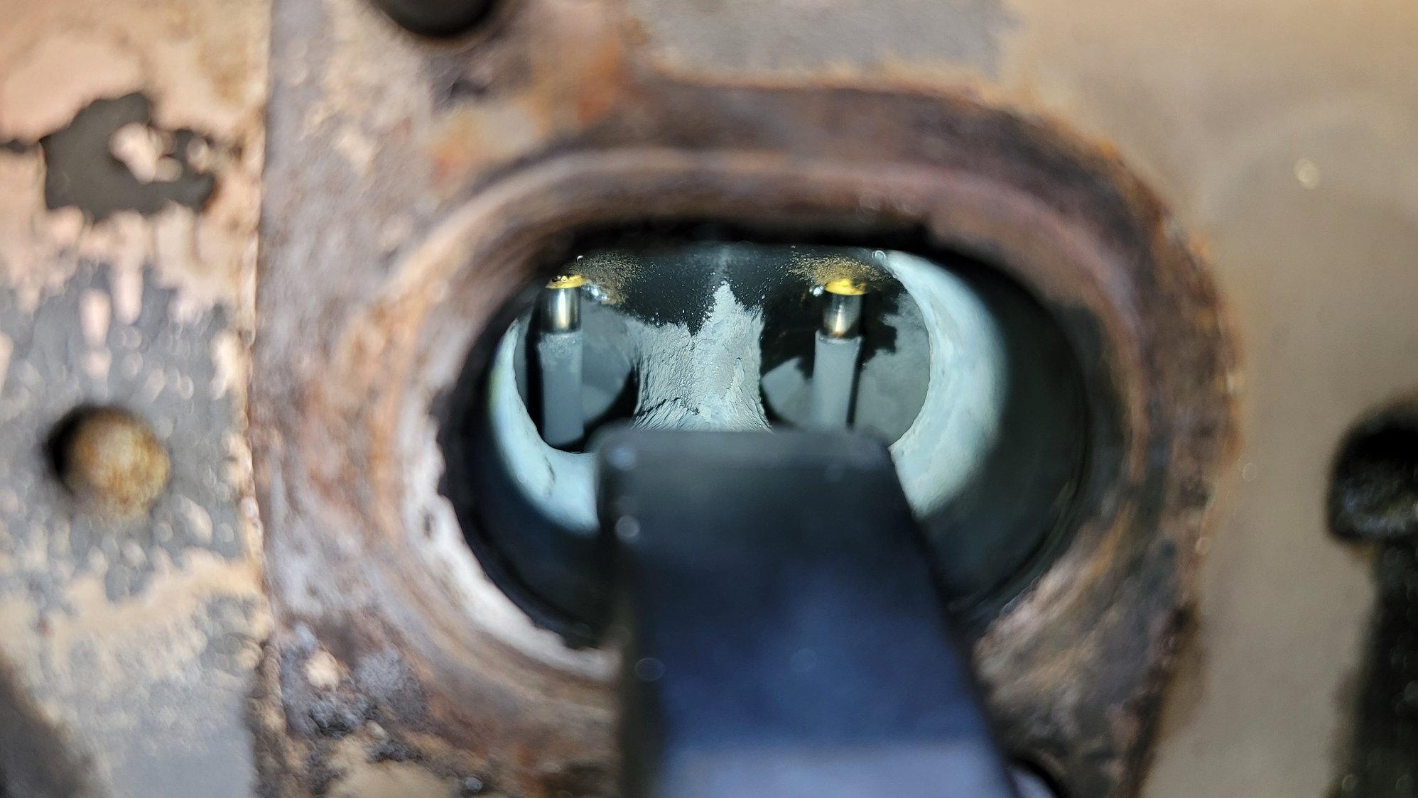

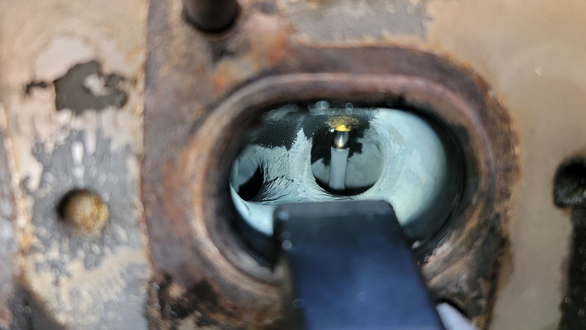

Ok so I had a busy few days with the mini. I put it in front end service mode and removed the exhaust and intake manifolds. With the exhaust manifold off I got a good view of the valves and took some pictures. It definitely looks like oil is seeping through the stem seals. Now I have to figure out what I can reuse and what I need to replace. I am going to get a new timing chain, but wondering if I need to change the gears for the cam shafts or that bottom gear on the crankshaft.

Yeah, it looks like they are definitely leaking. How do the intake valves look?
