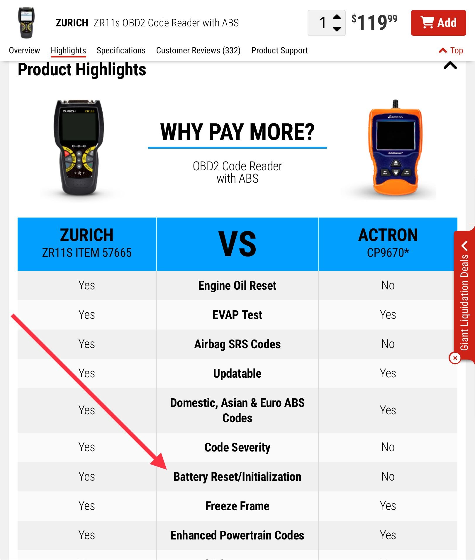

@JAMADOR ,
After checking the specs of your Blue driver scan tool, your Blue driver doesn’t have the features to register your new battery. However, as luck would have it, Habor Freight ZR11 scan tool for $120 does have this feature to initialize your new battery. Check out the photo below:

From: Houston, TX
Thanks, wonder of one of the auto parts stores can do it with their tool?
Would prefer to not add another tool, just for this, right now.
